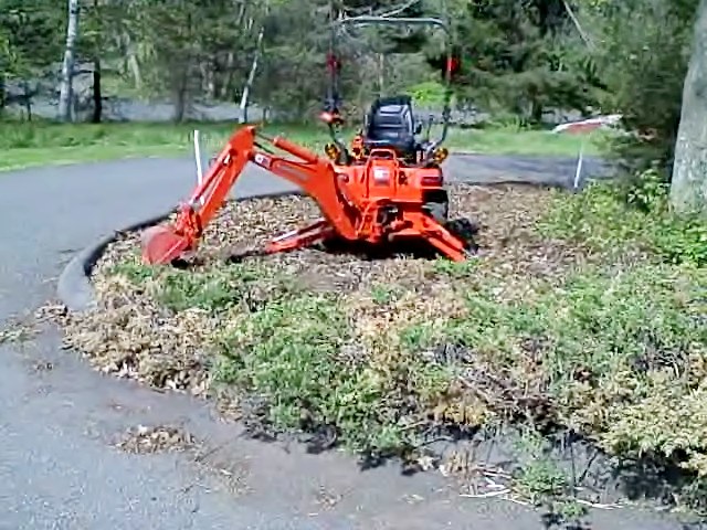

The beauty of a BX-25 on a slope is that you can shoot a stabilizer out on the downside for added protection.
