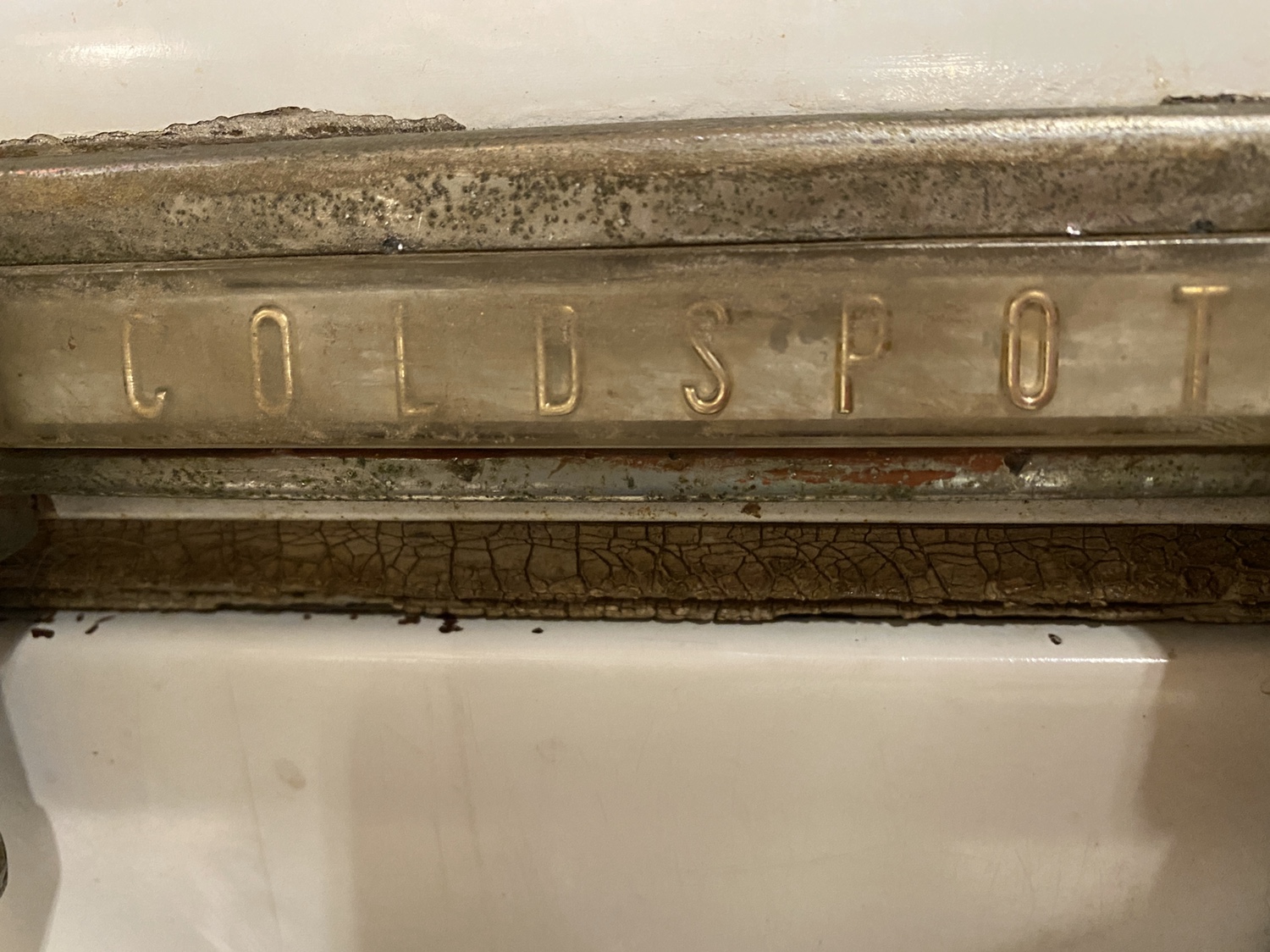

Our cold spot freezer was old when we got it 30 yrs ago. Still running good.
