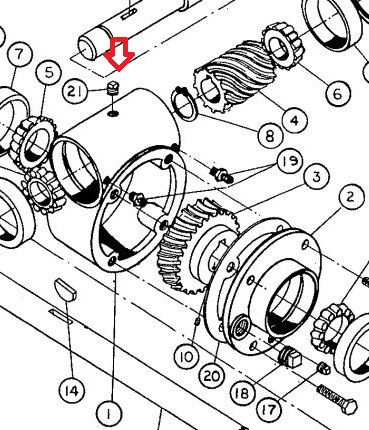

I do have one last follow-up question. If you look at the image below, i was adding gear oil to through the top (red arrow), but there are also plugs on the side of the gear drive. Number 18 and 17 are both a type of plug, but are really low on the gear drive. Was I putting gear oil in the correct spot? There is also a drain plug on the very bottom of the gear drive that you can't see in the image, so neither of those are for draining unless someone modified this in the past and added their own drain.
   / Are these holes for overflow of the gear oil??
#29
Another update from the manufacturer. I was told plug #18 is used to check oil level. So it sounds like the oil level should only go to the opening of #18 plug.
   / Are these holes for overflow of the gear oil?? #30
Item 19 are the grease fittings (nipples). Item you marked is for the gear oil - this lubricates the exposed gears shown, inside the gearbox. If you have a drain, then it will be for draining the oil out. The gearbox on my snow blower has the upper plug as a vent (plug with tiny holes drilled) or breather fitted. You could drill out the plug with very small drill if you feel inclined. If you shaft seals are worn you will see some evidence of oil in the fan housing of the blower.
HTH.
