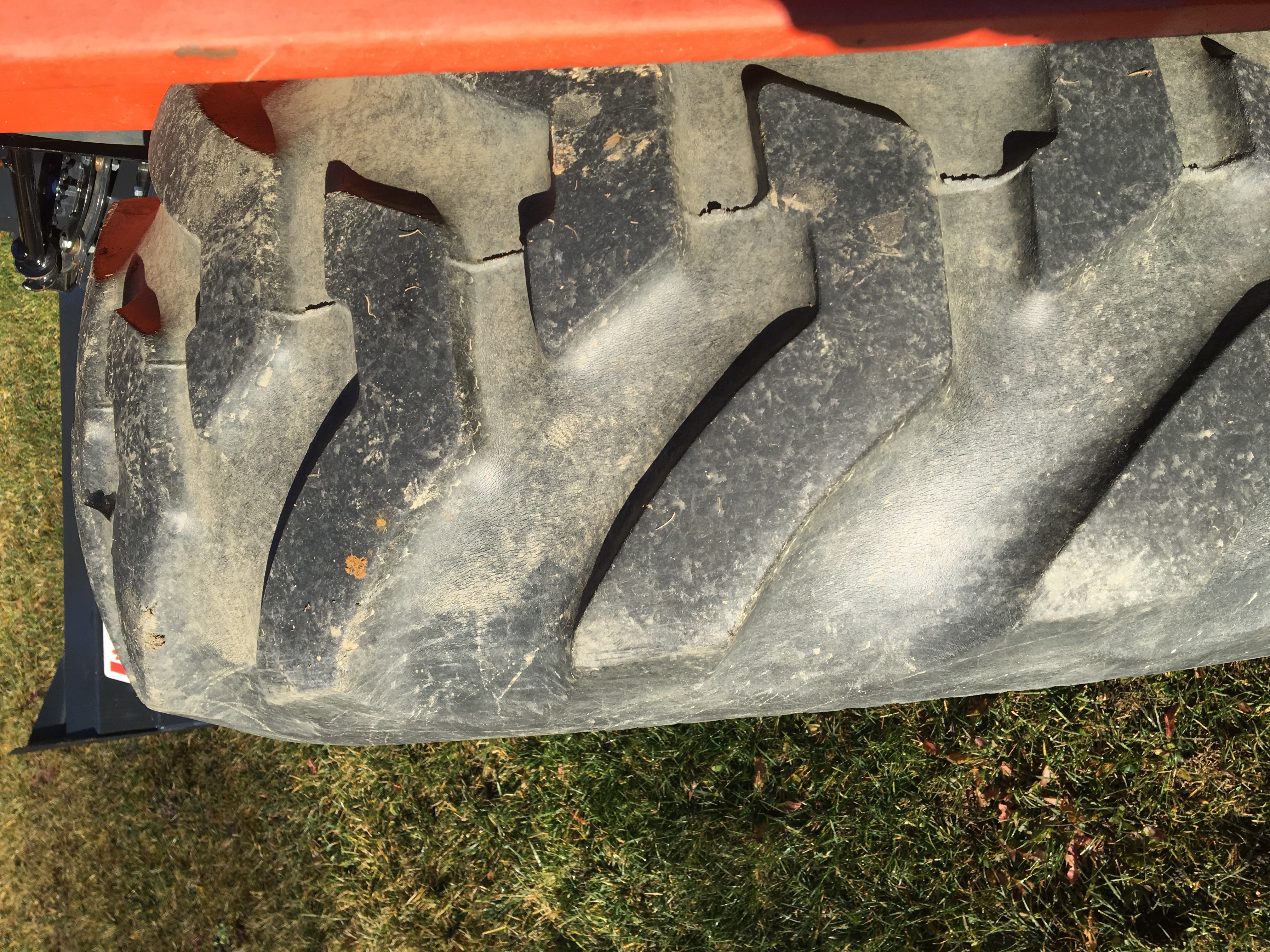

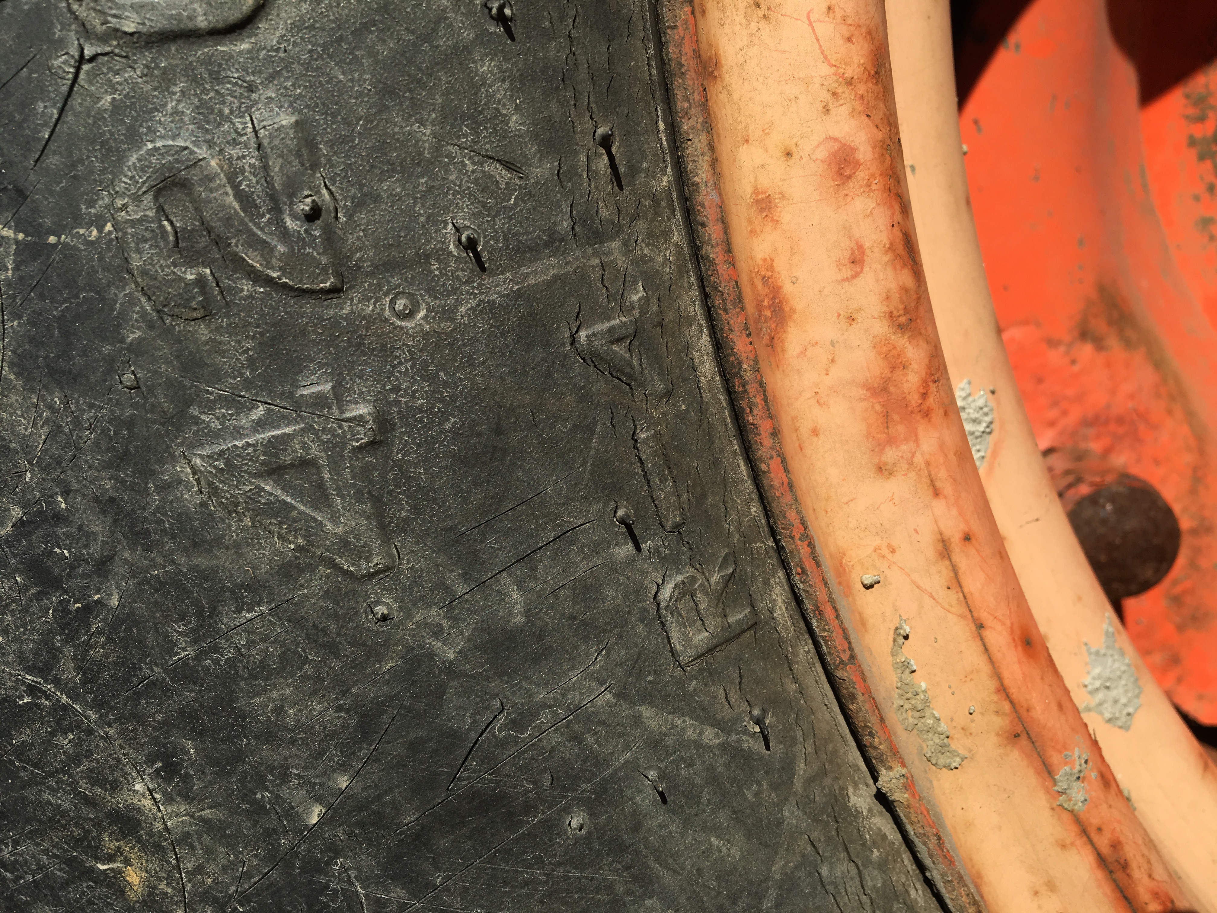

First tractor. Ordering chains. Pretty sure I have R4s just want to confirm before spending $900. Says R-4 on the side of the tire

I don't understand why the tread is broken at each lug. Any one speculate on that cause.

Yep. A bit unusual tread pattern. But R-4 none the less. :)
Don't know. Picked it up used a few months ago

I didn't figure that out either. But then,,,, I also couldn't figure out why they were connected in the first place?? :)

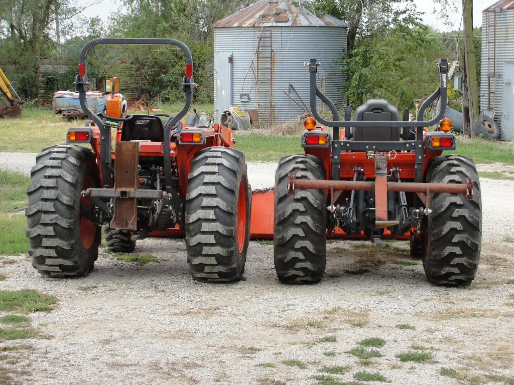

Here's two examples of what I know as a "normal" R-4. The one on the left are Titans. Can't remember what the ones on the right are.

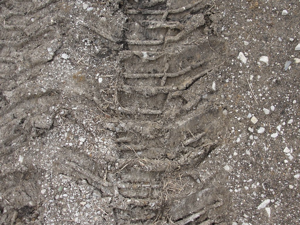

Grooved the rears on my L4400. No difference on snow. Slight difference on dry hard packed dirt.
Here's a pic of the track on dirt.
