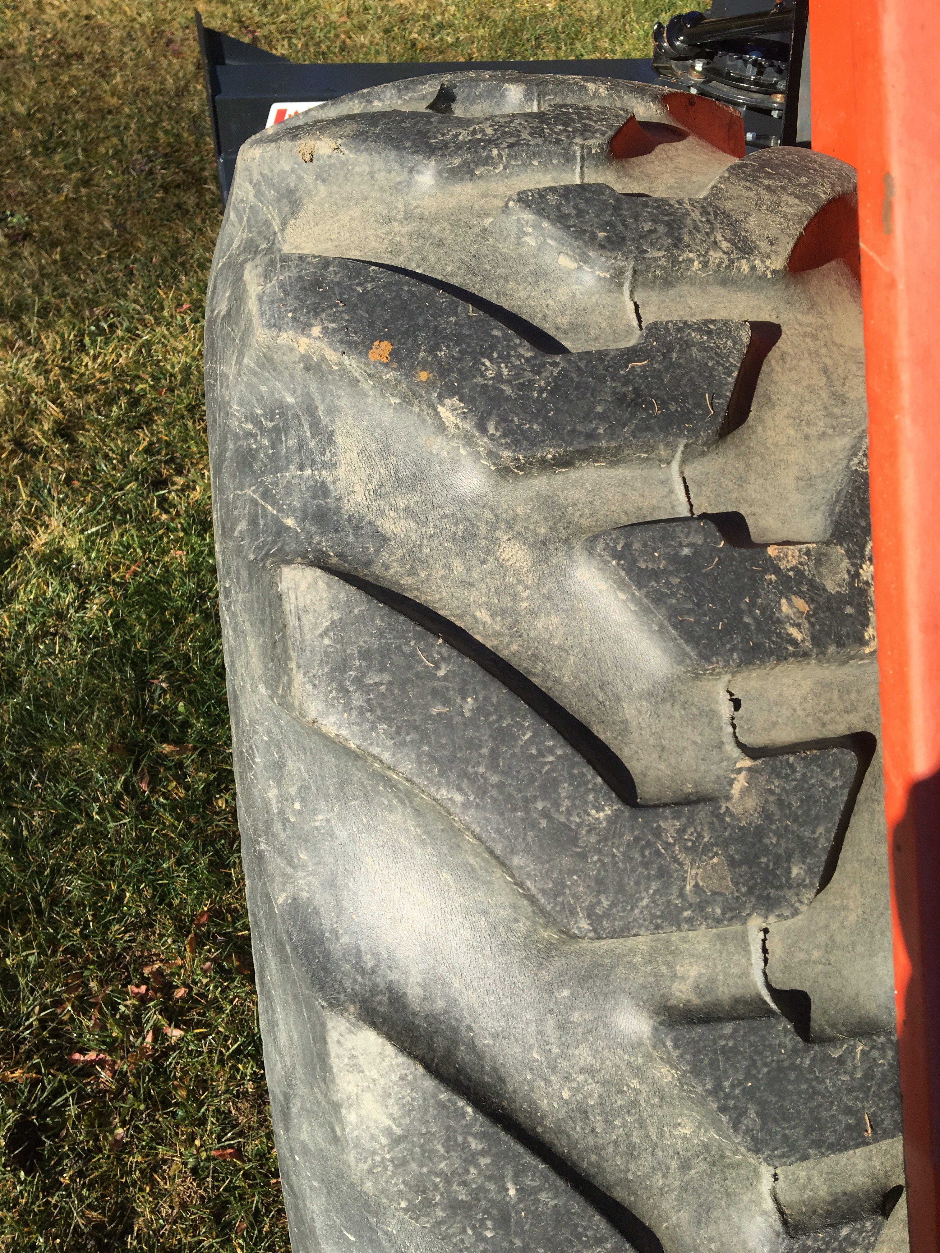

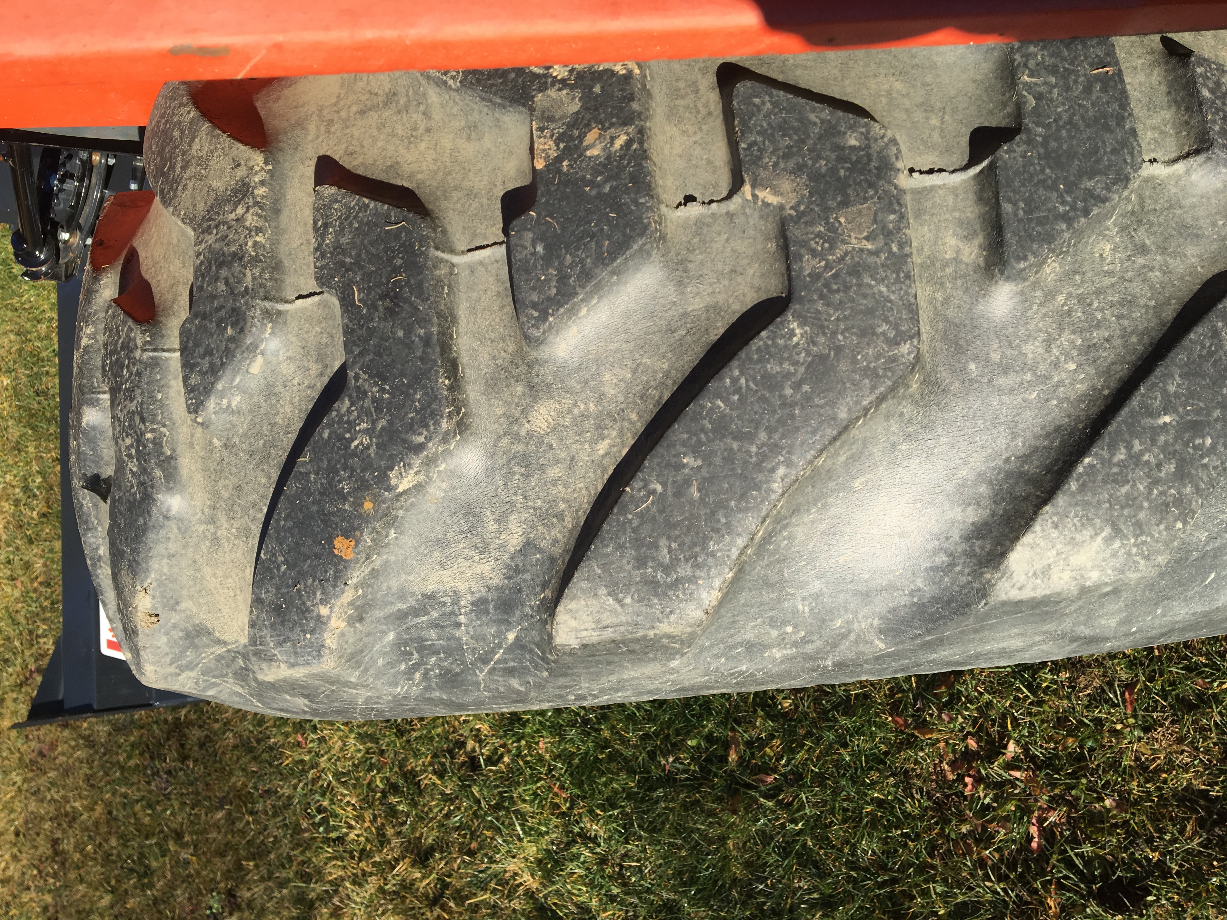

What about the sidewall cracking, and dry rot (second photo)?
These appear to be 15 year old tires (2001 Kubota) suffering from significant dry rot.
Those tires honestly look great to me. I wish I remembered where to find the article, but I read about a guy who found old Allis Chalmers tractor that he restored working order. Not a full restore, just made to function again. It was a huge 2wd ag tractor. He did a lot of tractor pulls with it totally stock running the original duals on the rear. The tires were like 45 years old!
My old 8n has rears that look like cr@p. TONS of weather checking. You could empty a pocket of change by jamming coins into the cracks of those tires, but they've got great tread and they hold air, so why replace them?
15 year old tires are no big deal.

I don't understand why the tread is broken at each lug. Any one speculate on that cause.
I think you are looking at the tire wrong. The dark part is the tread. The light part is the groove. It has the molding excess still in the groove
Edit. I didn't finish reading the thread. Looks like some one beat me to it.

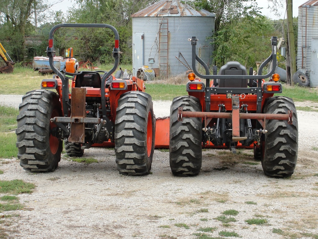

Here's two examples of what I know as a "normal" R-4. The one on the left are Titans. Can't remember what the ones on the right are.
Those tires are inflated much more than I run mine, but you might have them like that for a reason. In my case, I keep the tires inflated so the full bar width is in contact with the ground for best traction, especially in snow. A quick check can be done after driving on dusty gravel like those were in your picture. The one on the right is only making ground contact with about 1/3 of the tire tread. The one on the left, 2/3's. For me, that makes a huge difference in snow and ice. But, sometimes I inflate more for carrying heavy loads. Just thought I'd mention it since your picture is a good example for others when trying to improve traction and grooving.
