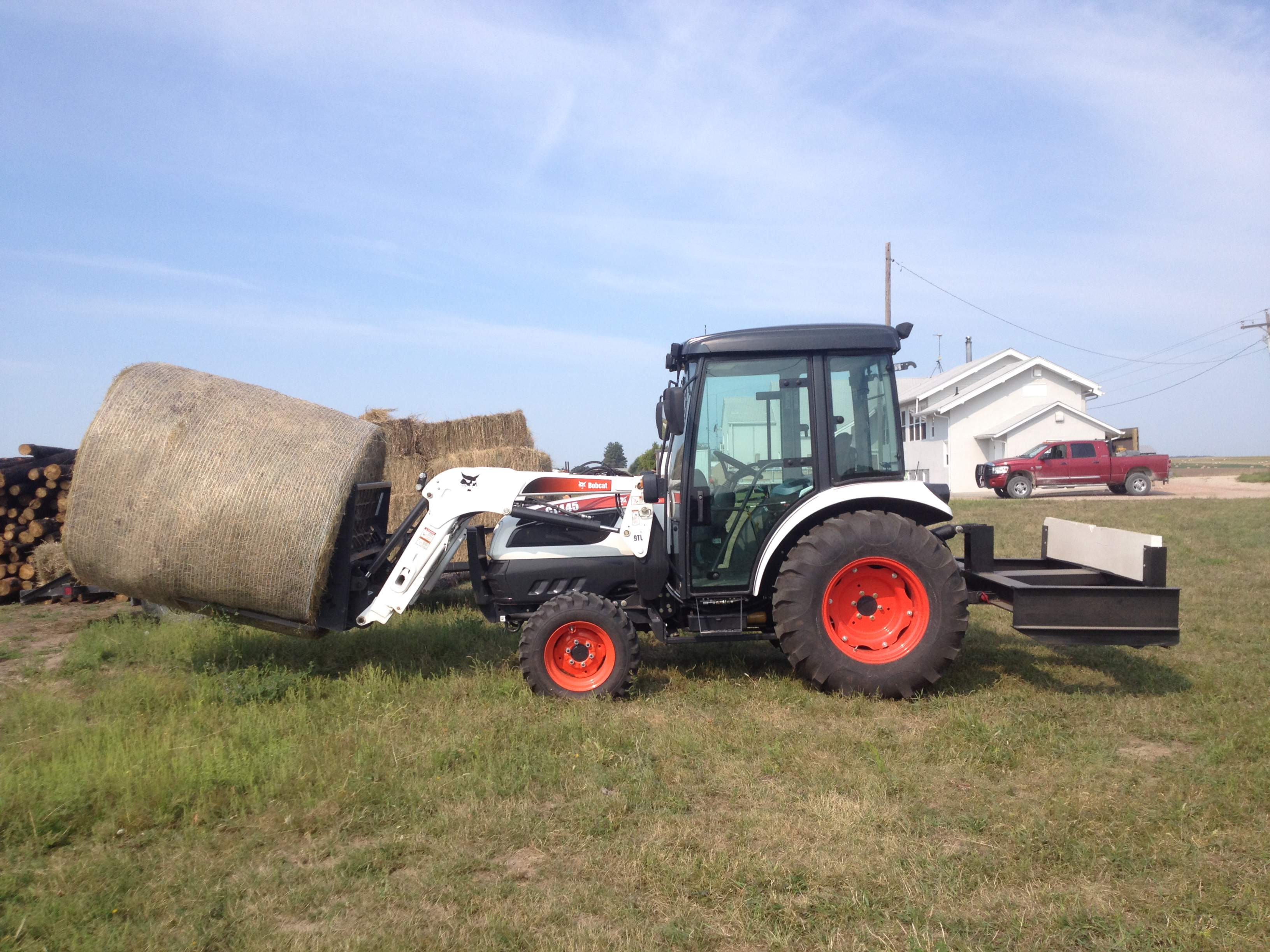

Here is a perfect example. My old tractor moving a round bale. Tractor weighs about 4,500. Attachments are probably another 1,0000 along with the bale with is around 1,500. Total weight is likely over 7,000 pounds. My guess is in that pic around 6,500 pounds is sitting on the front axle and little tires while only about 500 pounds is on the rear axle. This is why the fronts should be larger to match the weight they carry when using the loader.

I wouldn't necessarily care if the tire was a lot taller, just needs to be a lot wider on my B26. Those little 6" wide tires sink up too much in soft soil with a loader full of dirt.
I agree that a little wider would be good.
