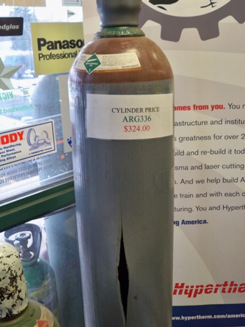

Sometimes when metals are drawn or rolled, an impurity or void from the original ingot can be "stretched" (for lack of a better term) until it becomes a pipe (elongated void...frequently referred to as a "linear defect"). Metals also have a grain, just like wood, when processed in certain ways, And, like wood, the grains may have weaker areas.
I'd guess the split resulted from one of the defects I wrote about above. Plus cycles of pressurizing and depressurizing stressed the cylinder.
I have no idea what non-destructive testing is done on a gas cylinder. I believe magnetic particle (Magnaflux) would be the most logical, along with hydro test or even a cylinder leak-down. However, due to the costs involved, I'd guess the only inspection is visual.

The marks where the cylinder was drawn looks rough to me. It could have created a weakness if the die equipment they used was damaged or faulty when it was drawn.

I noticed the marks, but did not think much about them... Can anyone explain what is actually done in a "hydro test" and why is it call a hydro test?... What does water have to do with it?
   / Argon cylinder that won't be filled again #16
Part of a hydro test is using water to pressurize the cylinder instead of air.
When a cylinder splits with water, the pressure reduces very fast and no explosive decompression occurs like with air.

Hydrostatic tests are conducted under the constraints of either the industry's or the customer's specifications, or may be required by law. The vessel is filled with a nearly incompressible liquid - usually water or oil - pressurised to test pressure, and examined for leaks or permanent changes in shape. Red or fluorescent dyes may be added to the water to make leaks easier to see. The test pressure is always considerably higher than the operating pressure to give a factor of safety. This factor of safety is typically 166.66%, 143% or 150% of the designed working pressure, depending on the regulations that apply. For example, if a cylinder was rated to DOT-2015 PSI (approximately 139 bar), it would be tested at around 3360 PSI (approximately 232 bar). Water is commonly used because it is cheap and easily available, and is usually harmless to the system to be tested. Hydraulic fluids and oils may be specified where contamination with water could cause problems. These fluids are nearly incompressible, therefore requiring relatively little work to develop a high pressure, and is therefore also only able to release a small amount of energy in case of a failure - only a small volume will escape under high pressure if the container fails. If high pressure gas were used, then the gas would expand to V=(nRT)/p with its compressed volume resulting in an explosion, with the attendant risk of damage or injury. This is the risk which the testing is intended to mitigate.[citation needed]

On How It's Made IIRC they were Hydro-ing the new cylinder at 5500 lbs.
They showed making from blank to finished cylinder!
