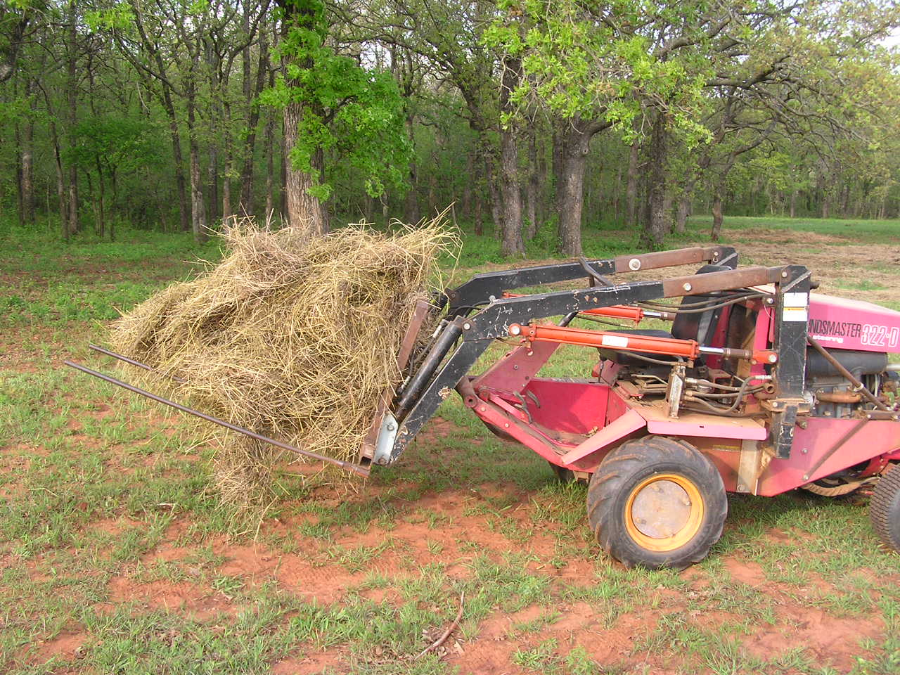

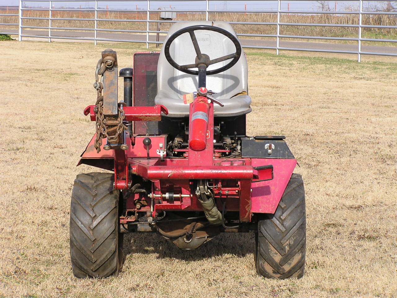

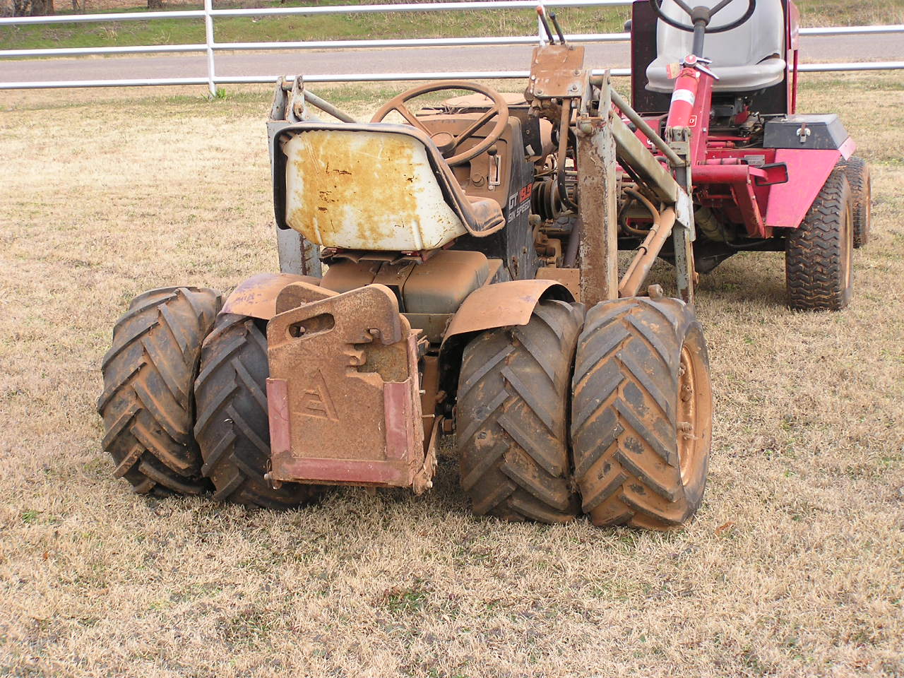

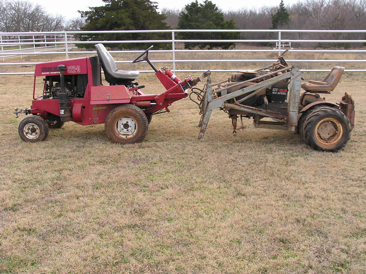

I think the rubber in a 20 year old tire might be better than the new ones made today.
These pictures were taken in December 2004. The R1 tires were over 20 years old then.
Still using two of the 30 year old tires now. :thumbsup:
