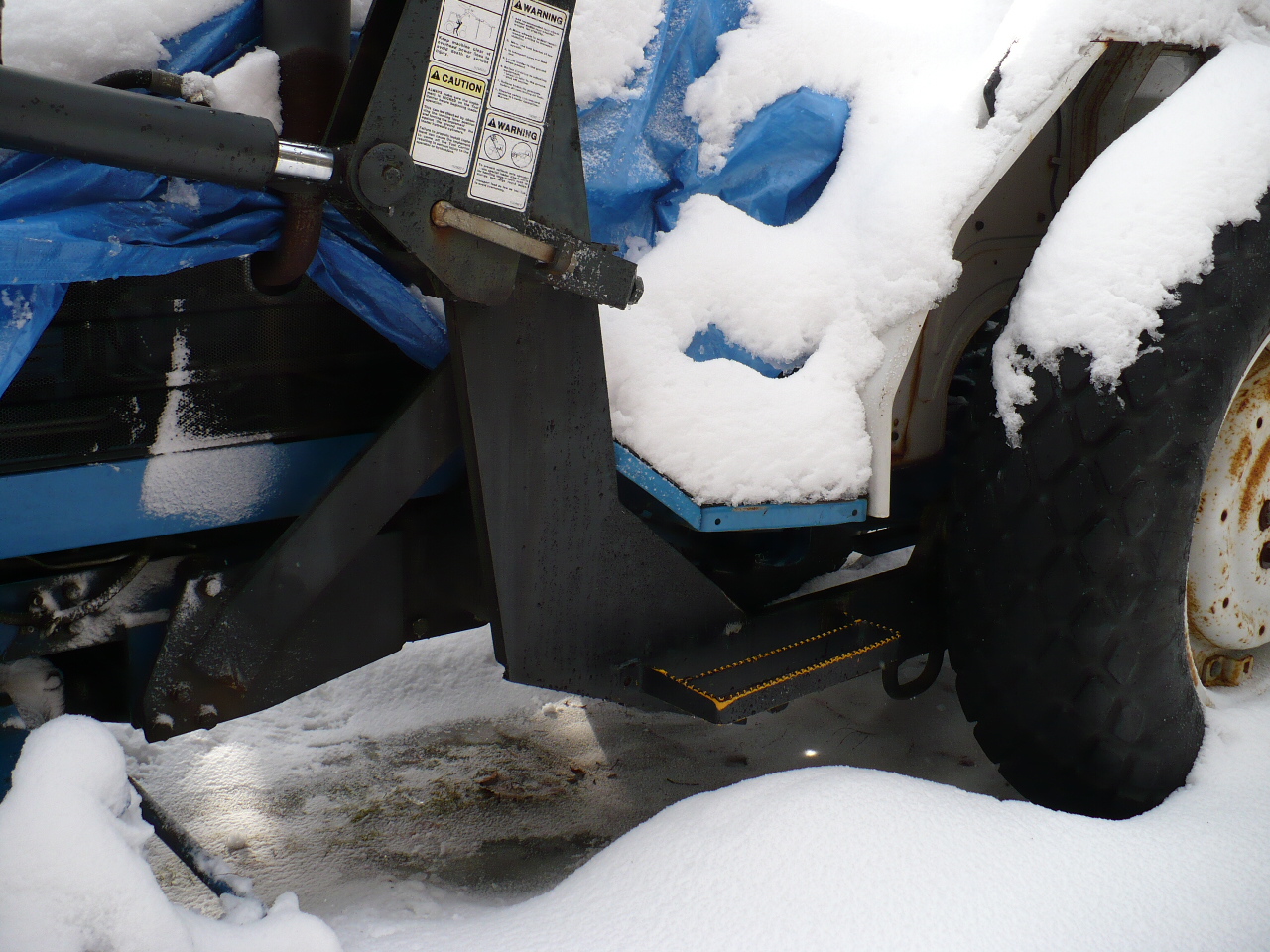

I don't want to distract from your main post, but on the discussion of the loader mount..
I took a few pics (I should have put more effort into it, sorry) of my 2120 with Alo loader. I know its a slightly larger tractor (its basically the TC 48-55) but it is still a compact and has basically the same type of block design, front axle mount and front axle. Just slightly larger.
What I am attempting to show is that it is solid welded steel, with bolts only on the rear axle mount, front axle support mount (which you can see), and the 4 bolts on the center housing (which you can't see). There is also a 1.25" solid steel rod with threaded bolted ends that connects each side under the tractor (it crosses just under the drive shaft). The design is solid and connects the front axle to the rear axle with out any bolted junctions in the middle. Most forces up down, side to side , twisting etc. are spread out along the entire tractor chassis. You could say (although it would not be entirely true) that the motor is just along for the ride...
I have two other much larger industrial machines, with very heavy loader backhoes from the factory. The same design holds true. Connecting front axle to rear axle with one solid or welded sections.
I am sure someone out there sells a loader for a approx. 30 hp tractor with this type of design. In my opinion, this is what folks should look for in a mount.

Thanks, this is EXACTLY what I had in mind.. basically fabricating brackets to tie the engine to the center and then that to the rear... It'll take a lot of time, and some trial and error, but it will make for a much more robust overall package..
