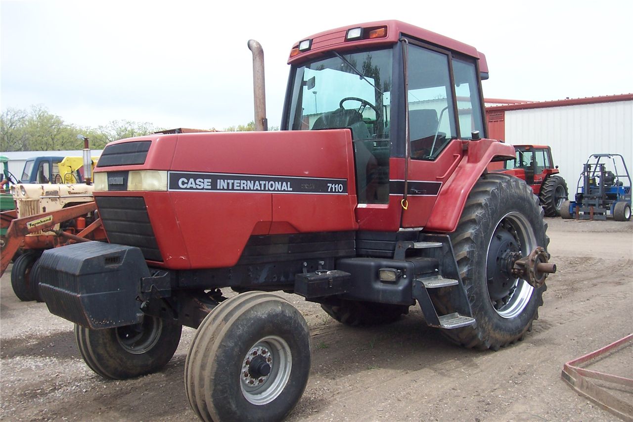

we pull the wagons with 2 case ih 7120s and 2 case ih 7110s
