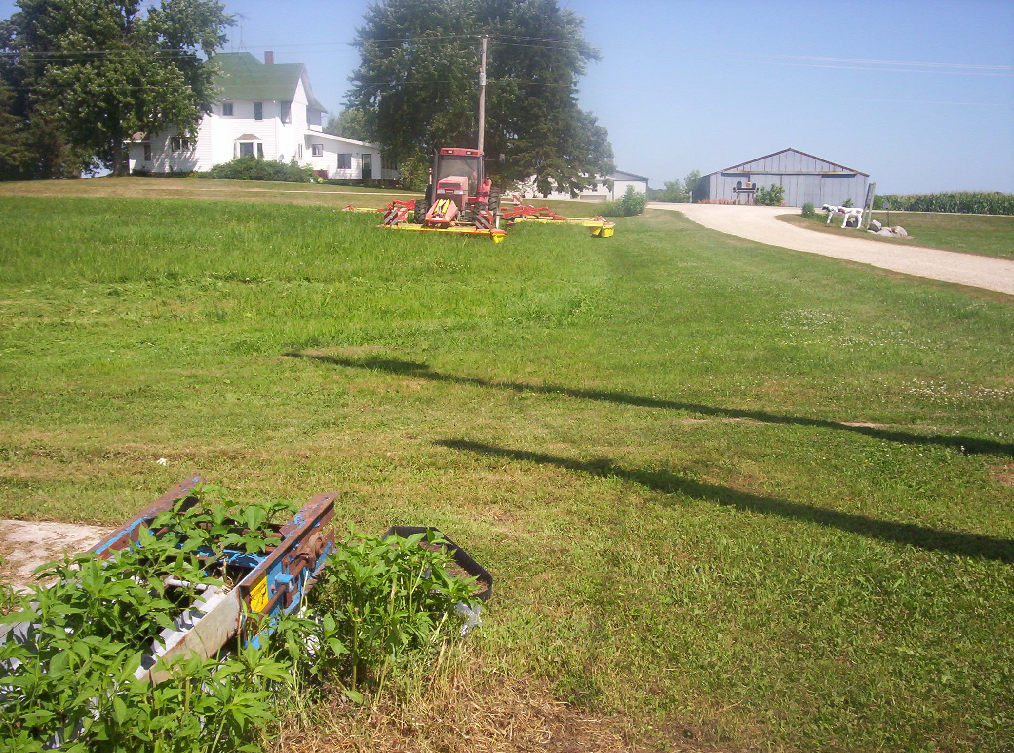

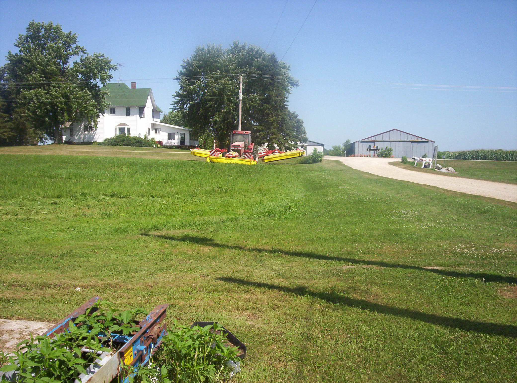

heres a start of the pics i said id take this is how we cut the hay so fast deereman 001.jpg

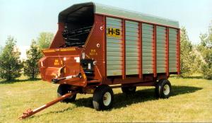

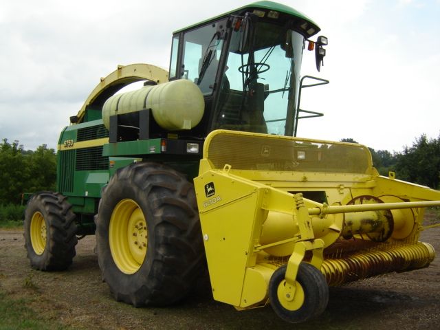

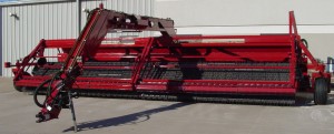

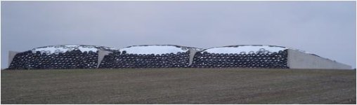

the tractor is a Case IH 7230 magnum we installed the front 3pt. hitch on the farm my dad bought the tractor for $50,000 a whole **** of a lot cheaper than a new one there are 3 10Ft mowers that cost about $50,000 total the mowers lay the hay as flat as possible so it dries quick then we come back with a H&S 30ft continous merger30-10.jpg around noon if the field was cut at 9:00a.m. then around 3:00p.m. we start chopping the field that was cut first we use a John Deere 6750 Self Propelled Forage Harvester with a 15 ft pickup head on the front we blow the copped hay in to1 of 4 H&S 7+4 18ft chopper boxes HD74MAIN.jpg we have 4 tractor devoted to pulling chopper boxes during chopping season we have 2 Case IH 7110 Magnums78041723.jpg and 2 Case IH 7120 Magnums77761247.jpg we store the feed in to bunker silosbunker8.jpgwe pack and pile the feed using a Case IH MX270 with a 12ft blade mounted on the rear 3pt. hitch78090118.jpg note only the picture of the Case IH 7230 with the mounted mowers was taken at our farm the rest of the pics were pulled off the internet

On your 7230 that you cut with, what do you mean you guys installed the 3pt. hitch? You can do that? Did it come from the factory with a front PTO? That seems like a lot of work. I wasn't aware that this could be done on a tractor that was not built like that from the factory.
Great pics! Thanks.
   / Article: Hay in a day (when to condition . . .) #24
yeah the front pto is run off of the crank shaft of the engine and goes through a converter that converts the crankshafts speed to 1000 rpm at the pto when the tractor is at full throttle it took us about 15-30 hrs of work to install the front PTO we could of bought a Fendt tractor but they were a little pricy $60,000-$100,000 for a used one and since we already had other Case IH magnums it would be a lot easier for peopl to drive the tractor when we dont have the mowers on it and its a lot quicker for us to get parts for the cases compared to fendts and case parts are a little more readily avalible by me but except for a lot of grinding between the radiator and the frame the front 3pt hitch was pretty much bolt on and it was pretty heavy it was about $10k for the front hitch(not installed)

:eek: LOT of WORK
   / Article: Hay in a day (when to condition . . .) #26
sure was
