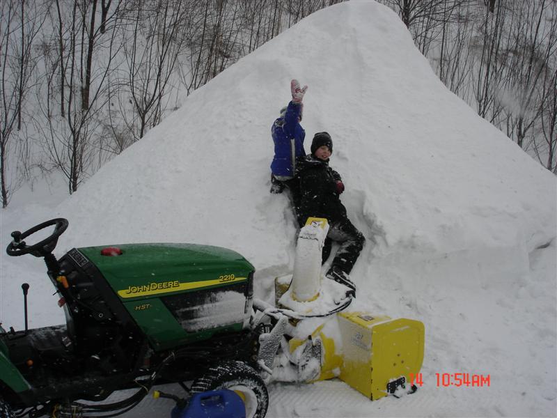

Some of you may have been reading the post about the 47 blower on a 2210 that is very loud. Well after the snow we got in PA over the last day or so mine is shaking and rattling its self apart. I have had to put numerous sheer pins in just because they work loose after 10 minutes or so. What I would like to know is have any of you had and issue that you contacted Deere corporate about? Where and how did you contact them? Mail, Phone? My dealer has been a great help but now I think I need to at least ask Deere to address the issue. Any advice on how to proceed? Picture 024 (Medium).jpg

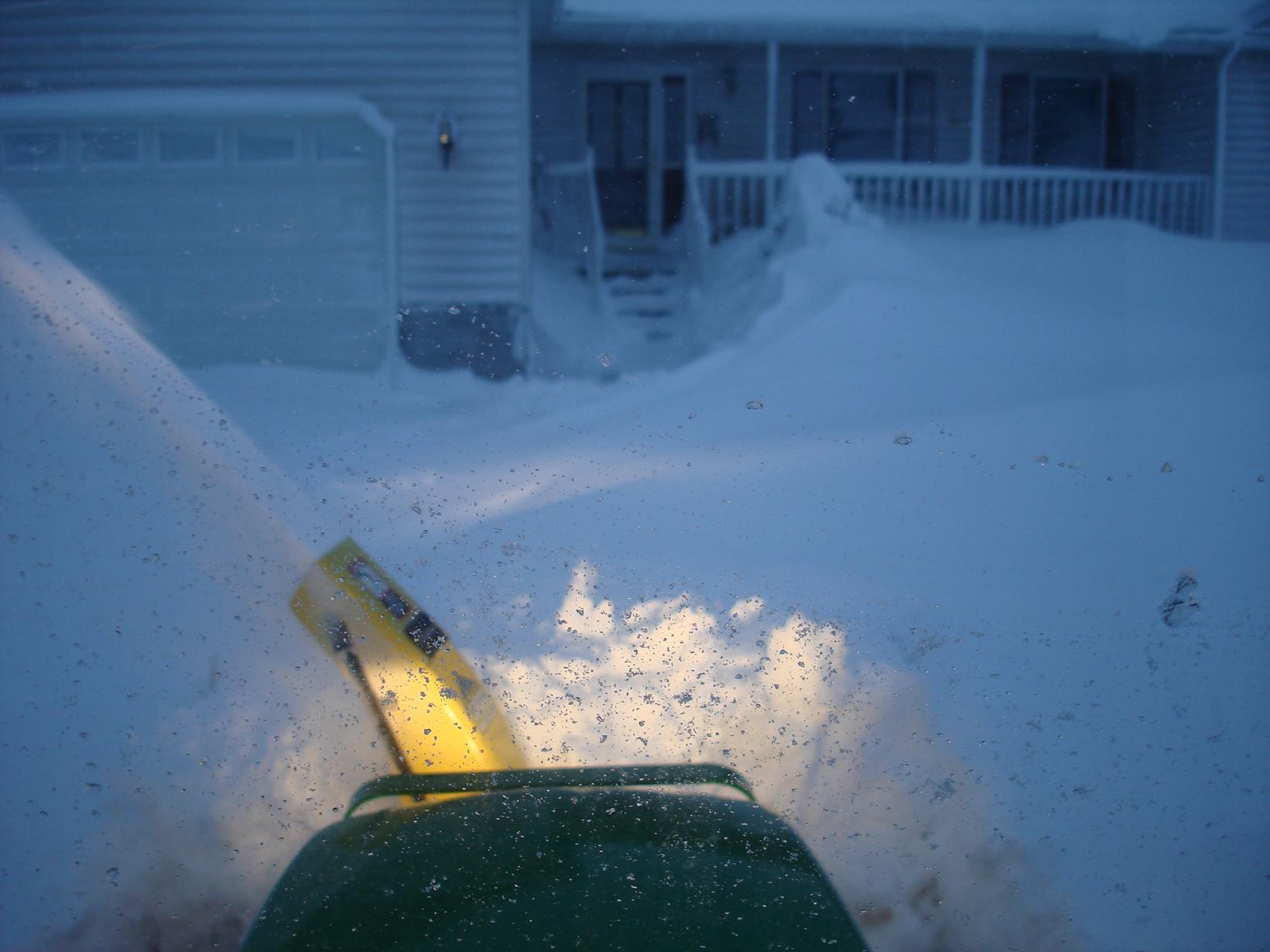

I’ve been spraying the drive chain every day with WD-40 and it has definitely calmed it down. But it still isn't as quiet as it should be for the price I paid for it.
