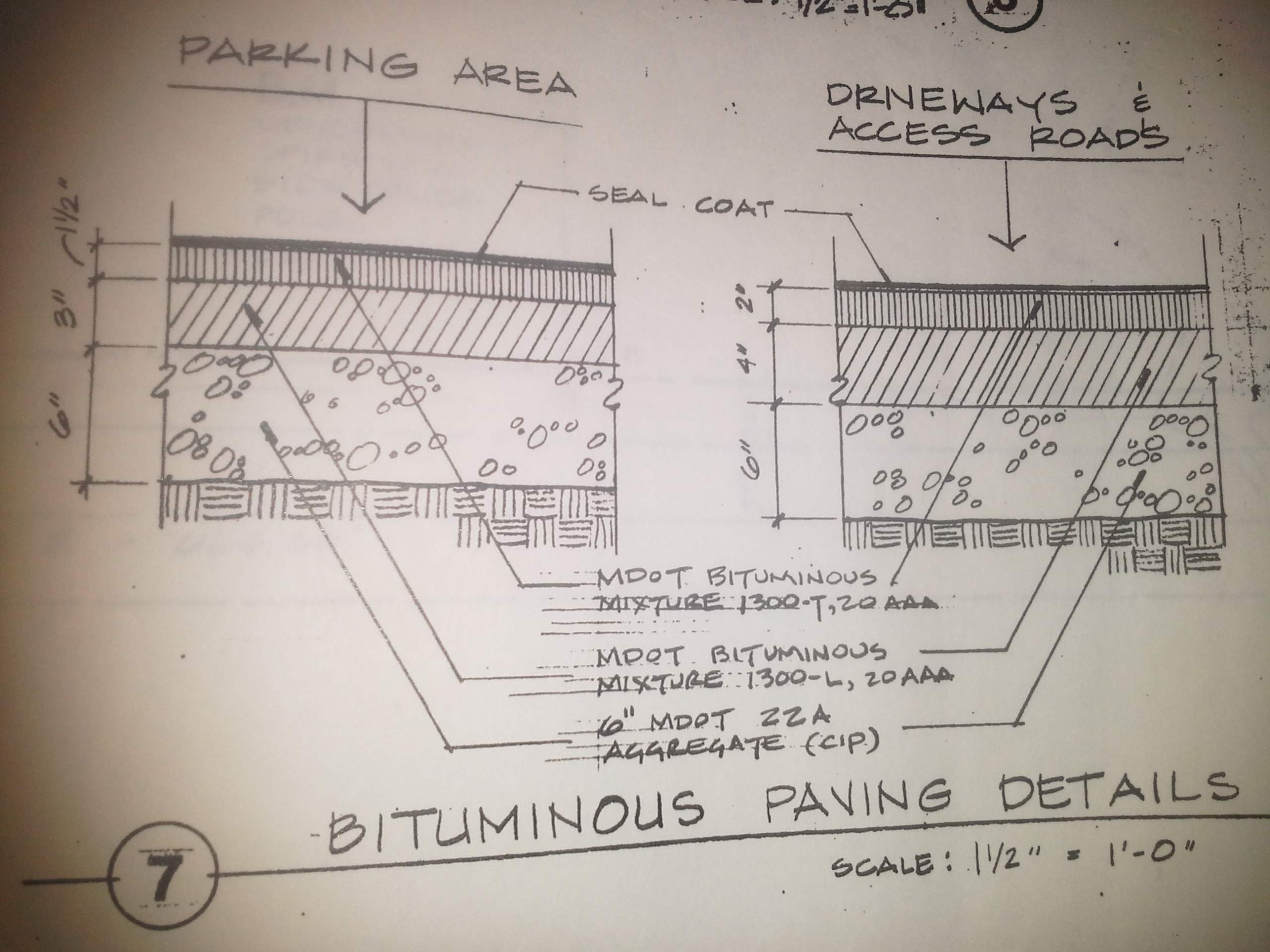

A durable fix though not a cheap one is to pulverize all the existing pavement along with part of the six inch agg. layer. Then spread trap rock (or whatever you call it locally) 1 -1/2" to #4 at the rate of 0.17 tons per square yard over the surface and mix it in with another pass of the reclaimer. Then repave with two one and a half inch lifts of half inch top mix. You will end up about six inches higher then you started. In places where you have to match edge grade cut out and remove enough material to make room for the new stone and pavement before you add the stone.
The reclaimer should cost about $1.50 per square yard, the stone $3.75 and three inches of new pavement $16.24 for a total of $21.50 per square yard. More of course if your lot is small with a lot of odd corners etc.
   / Asphalt alligatored: Crush & Shape or Mill & Cap? #22
A few core samples should tell you what is going on. Then base a repair on that information.
With costs being consider the chances are milling some off and adding a top lift will be your preferred choice.
   / Asphalt alligatored: Crush & Shape or Mill & Cap? #23
I agree, except I have no idea what trap rock is. You can add asphalt emulsions to the mix or Portland cement. Neither is a cheap method,, and few "site" contractors have the equipment. Around here only about 3 out of 5 road builders have reclaimers; and almost none of the site/parking lot types do. And those prices sound about right for 5000 square yards and up; but would be a lot higher for a 100 Sq yard lot.

Trap rock is hard durable stone made from blasted and crushed bedrock. it has sharp edges from the crushing process that keep the the layer interlocked under load instead of rolling around like marbles as in river or glacier polished material. It's hardness keeps it sound through repeated freeze thaw cycles where other softer rocks turn to mush. In short "the good stuff". Adding Portland cement is a waste of time and money as it works against the asphalt cement in the old pavement and can create a slab with joints problem that makes frost heaves much worse then other options. Adding asphalt emulsion or cut back asphalt is also of dubious worth as you are not trying to make a pavement out of the base but a superior base. When you brake up an old pavement you are limited by the maximum size of the original aggregates. Unless you are talking an old interstate pavement the maximum size is most certainly one half inch and the reclaiming process breaks down those aggregates so if you removed the residual asphalt and screened the remainder you would have a material that passed for sand, not gravel or crushed gravel. you need to add the missing parts, not hope some extra glue can hold together the wrong parts. The 1.5 inch to 0.25 inch hard crushed rock is what is missing. You are right about the difference between small jobs and main line construction. It dose cost a minimum amount to move the required machinery to a job site so there is a point where it would be cheaper to just have the small contractor to just remove everything that is there and replace it with new material, but times are tough and some of these machines are sitting idle so a cash customer might get a very competitive price. Don't expect anyone to understand the adding stone component though, it hasn't made it's way through the bureaucratic maze. They are happily specifying things like Portland cement and micro seals that have been shown to not work but still have support at the highest levels.

23 years for my western Washington county's Public Works Department doing design, construction inspection, materials testing, plan review, and determining the best method when the original plans just are not going to work for roads and bridges.
Last year one of the roads that we were repaving had a similar problem as you are describing. Before deciding on the best fix we did the investigation that I previously suggested, and saved a lot of money because it was determined that the lower layers were fine. We removed the bad portions of the top layer and patched it and then paved over the entire road rather than removing the asphalt full depth.
