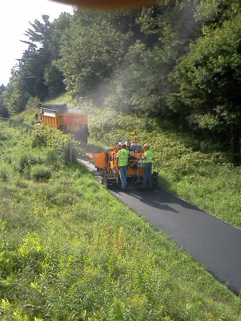

Thirty two years with the NH DOT as a technician and contract administrator. :D

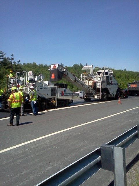

NYCMA certified asphalt quality control technician, as well as NPCA/ACI PCC concrete certified with 8 years experience in design, testing, adjustment and application of superpave and marshall mix designs. I live in the adirondacks of northern new york, working for the area's largest asphalt and concrete supplier. Our three person team is responsible for 7 quarries, 8 concrete plants, 7 asphalt plants, and numerous sand and gravel operations. I've been responsible for meeting the quality control requirements for many, many thousands of tons of mix, my biggest year being over 170,000 Ton supplied to a single job on Interstate 87 in northern NY in 2009. I can smell the asphalt oven as I write this. It's what I eat, sleep, and breathe. While I don't claim to know all there is to know, my knowledge puts the food on the table for my kids.
