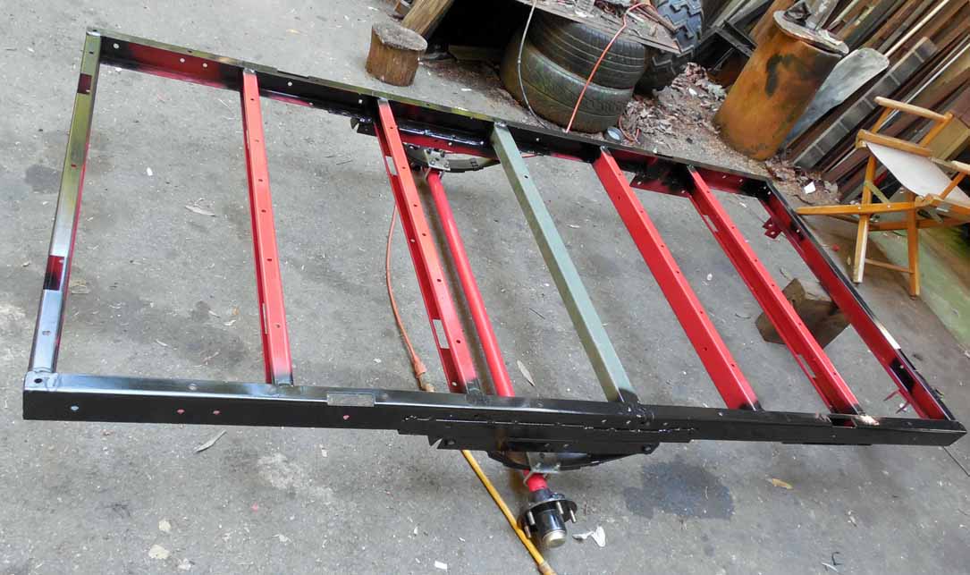

I needed a small trailer to haul lumber, trash, bring snowmobiles in for service, etc. Didn't want to spend much and needed enough length for a snow machine so settled on the HF 1,720 lb trailer kit. The folding model is more popular but I have room to store this and like the higher capacity. It has 12" steel wheels. Paid $279.
One caveat: this kit comes with a certificate of origin. Some states require a state inspection of kits in order to be registered or titled, which would add a cost that might not be worthwhile.
The kit comes in two boxes which weigh a total of around 200 lbs. The HF guys will help you load it in your car. It fit easily in the back of an Outback wagon. One box contains the wheels and small parts: the other contains the frame members and axle and is much heavier.

Here is the box with the frame:
And the wheels and small parts and fasteners.

One thing that might be worth checking is the wheel bearings for grease, cleanliness and proper preload. You just never know what you have considering the source.
/ Assembling Harbor Freight 1720lb trailer
I was going to get to that. The bearings are packed in a clear preservative, NOT Bearing Grease! The instructions tell you to clean and pack them, but not all take heed.
The front bearing comes right out. I then put the hub in the middle of a wheel to hold it and used a large socket and extension and knocked the rear bearing and seal out the bottom of the hub. Cleaned the excess preservative grease off with Citrus Degreaser and then use brake part cleaner to thoroughly clean the hub and bearings. I packed them by hand while wearing gloves, then cleaned to gloves with some paper towels and brake cleaner to reuse them.
The bearing is 30205 Taper Wheel Bearings, 25mm i.d. x 52mm o. d. x 16.25mm thick. Local parts stores may or may not have them.
The bearing seal is a 52 x 30 x 10.
Some people switch to 1" hubs. They fit the axles (25mm is 0.984") and allow you to use readily available bearings, seals, and caps.
This trailer is assembled as two 4'x4' square sections with a yoke in front. You begin by building the front section (which has a cross member), then the yoke, then the rear section, then bolt the two sections together. You add the supports for the springs and axle, then put on the wheels and hubs and wire it up. It takes most people 4-8 hours.
I used a steel carpenter's square to keep the sections square and that was easy. Also put a socket extension on a cordless drill to run in the nuts.

So i have the frame assembled and hubs on. The tires came with 30 psi and max load capacity is at 80 psi so be sure to air them up.
When you knock out the rear bearing seal, be sure to look out for the grease fittings on the back of the hub: I broke them. They were brass: I replaced them with steel ones (6mm, straight).
Wiring it up this morning. I'm adding a wire ground as the powder coating and bolted assembly makes frame grounding spotty.
I'm going to solder and shrink tube everything, but I think I'll use spade connectors for the lights so if I want to switch to LED lights it will be easier. For the amount I'll use it I kept the stock lamps for now.
