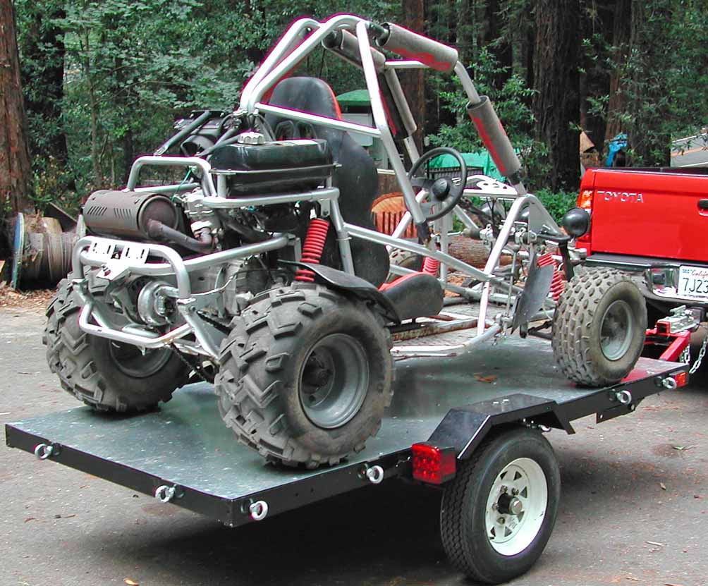

I've had good service from the 40" x 48" version with 8" tires. I bought the first one to be a jeep trailer for camping gear.
A couple of tips:
California required a vehicle inspection to get plates.
Maximum rated tire pressure is far too much. A tire pressure chart says 28 psi is sufficient for the light loads I carry in it. (from memory I think 28 psi allows 600 lb load). Inflated to the limit shown on the sidewalls, it bounces too much.
Just put a 2" hitch on these and be compatible with the rest of the world to avoid future hassles. I put refrigerator rollers along the back of the chassis, to stand it on end and move it around.

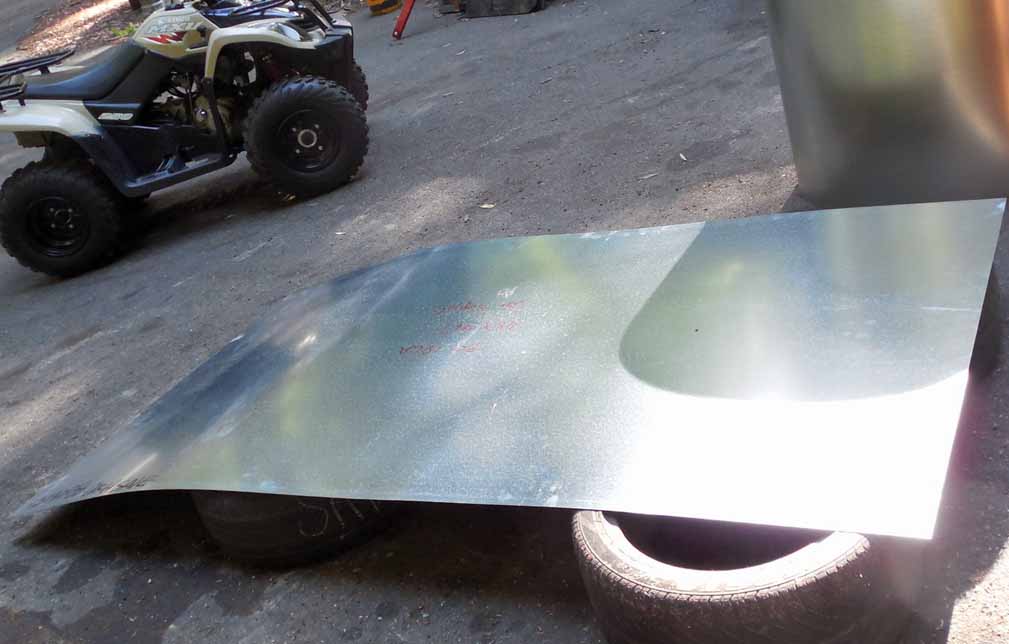

I used 3/8 plywood for the walls to keep the weight down. One sheet did the whole trailer. Something like 23" walls on the sides and 25" front and rear extending down over the chassis. With this wall height and 8" tires its easy to reach over all sides into the trailer. (Photo)
