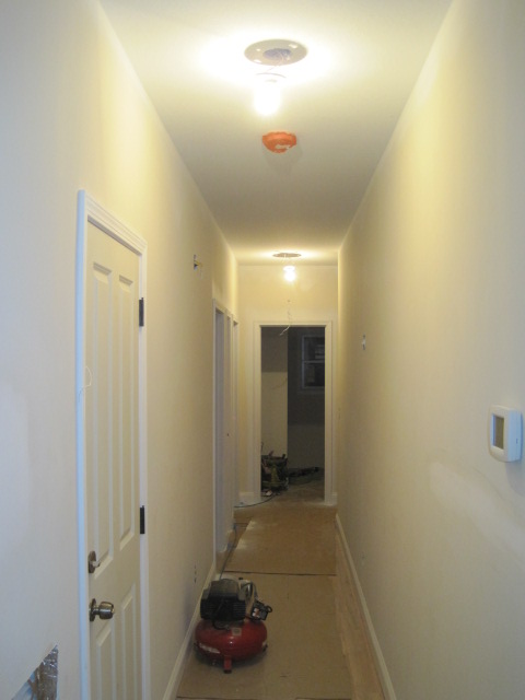

Its looking good! Another suggestion that Mike in WV touched upon, is what kind of texture do you want on your walls and ceiling? I like the rougher texture on the cieling, it hides a lot, and a "knock down" on the walls. Its basically just dry wall mud put on thin and spread out. It provides a little texture, I like the looks, and it hides any minor problems with the dry wall.
Knock down isn't mud. The same product can be used for a few different types of texture. It can be sprayed on and left as is which will provide a very rough texture. Once it has a chance to partially dry a wide plastic knife can be use to "knock down" the texture. It's great for ceilings as it hides imperfections in the drywall finish.
I'm not a fan of knock down texture on walls. First off, the door and window jamb widths have to be increased. Custom jamb widths can get very expensive.
Secondly, it can be tough to patch knock down without the patch being visible.
Third, it takes more paint, and makes cutting in around trim much more difficult.

Knock down isn't mud. ... It's great for ceilings as it hides imperfections in the drywall finish.
We plan on putting knock down on the ceilings but will leave the walls plain.
I don't care for knock down on the walls because it seems like the texture will collect dust and dirt. Plus, I suspect knock down on the walls may be a passing fad and will date a house. If you ever wanted to undo the knock down on all the walls in your house because it went out of style, I imaging you'd have quite a job. It might be worse than removing wallpaper. Plain simple painted walls have stayed in style for decades. The walls used to be made with plaster, then drywall came around. I suspect that plain drywall walls will still be in vogue 30 years from now. Even if a product comes out that replaces drywall, I don't think you'd have trouble selling an older house with drywall because drywall is so easy to work with.
Knock down on the ceilings makes sense. Knock down hides the imperfections and can be re-painted. I don't see knock down on the ceilings as a passing fad because of these reasons.

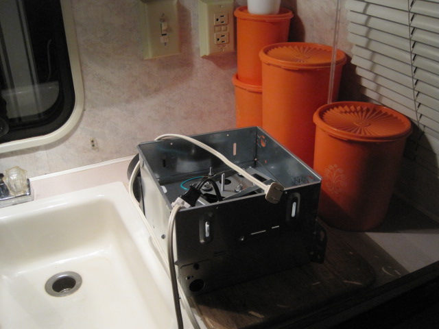

I really, really, really dislike a noisy bathroom fan. A loud fan does not provide a conducive reading environment. LOL.
attachment.php
The wife brought a couple fans home so I could "approve" them. The fans had electrical plugs on them so I just plugged them into an extension cord and tested the fan noise. Both fans met my approval.
In the master bath we plan to have a combination fan/light in the tile shower and a fan/light in the toilet stall. The master bath also has a window in the toilet stall and a window over the claw-foot tub that will help with ventilation. The hall bath will have one combination exhaust fan/light. We would like to have separate switches for the hall bath fan/light so we can turn on the light without having to turn on the fan. We just have to make sure we have a large enough place for a multiple gang box for the switches.

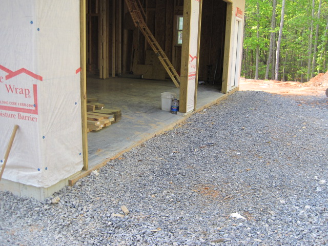

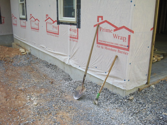

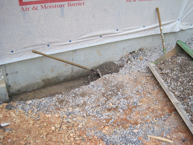

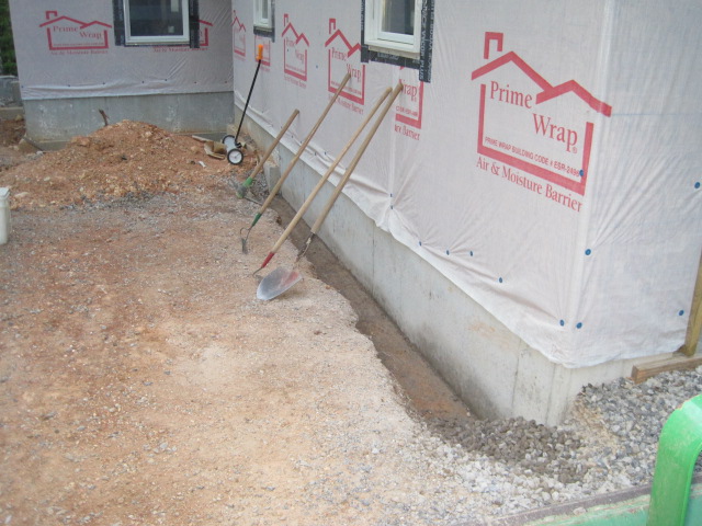

Uncovering the Footers so that Brick Can Be Laid
It seems like I live to dig.
We have gravel covering the footers that surround the garage. I need to uncover the footers before the brick can be laid because the brick will sit on top of the footers.
attachment.php
Tonight after work I removed the gravel covering the footer at this section of the garage in preparation for laying brick.
I couldn't see a good way to use the backhoe so I hand shoveled the gravel into the FEL and hauled the gravel to a gravel pile.
attachment.php
Here's the uncovered footer after a couple hours of hand digging.
I believe I may be able to use the backhoe to uncover the footers in front of this section of the garage.

what brand of fans? I got some noisy cheap ones I would like to replace. someone mentioned once in a thread they liked some panasonic ones.
   / At Home In The Woods
#1,127
NuTone. The fan noise is rated in Sones and is posted on the box. We found that 3 Sones or less was quiet enough for us.
