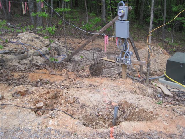

Electrical Trench Work Continues
After work today I dug some more near the transformer/pedestal area.
attachment.php
attachment.php
It was a little hairy digging so close to the temp pole. At normal tractor RPMs, sometimes the backhoe boom gets away from me and swings real fast and can hit something. My joysticks are a little touchy. So I ran the RPMs on my tractor lower than normal to slow the boom swing speed. The unfortunate part of this equation is that the backhoe moves more slowly and it takes me longer to dig. But that's better than tearing up my temp pole or getting electrocuted.

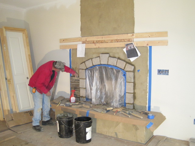

Tomorrow the fireplace installation begins.
