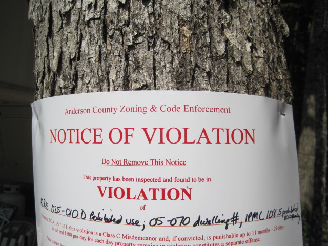

The beaurocrats found us. We have 60 days to move out of our camper or face a $500/day fine. We will not be ready to move in the house in 60 days.
attachment.php
The code officer who served the notice listed R2 (residential) zoning to back up the notice. I told her that we are zoned A2 (agricultural). She said it didn't matter, that we couldn't live here on A2 zoning either.
Yesterday we had our rough-in inspection and electrical inspection. I suspect one of the inspectors turned us in.

I think it is an office trailer just my opinion that you let the baby sleep in :D

That is total BS at this stage of building. They should have inspected the property when you applied for a building permit. Check with a lawyer and tie it up in appeals at the worse scenario. By then maybe the house will be done.

If you check with a lawyer, make sure he's a "land use attorney". They should know the zoning laws inside and out.
