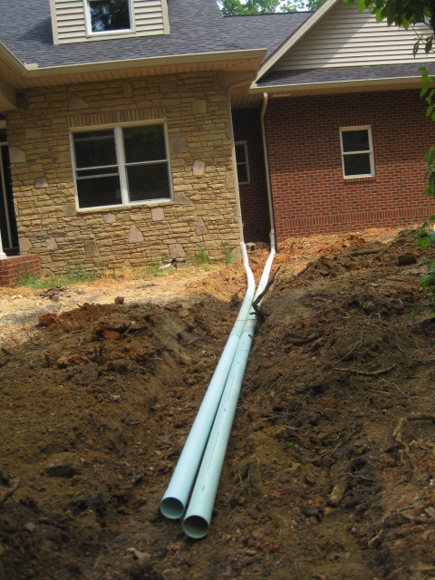

More brick pictures.

The wife met with 2 security companies today. Today's meetings with the security companies gave us hope that we might be able to sub out the security wiring. She also met with one vinyl siding/soffit/guttering sub. We have estimates from some other vinyl subs but wanted some more.
Obed
   / At Home In The Woods #1,560
Dat's a lotta brick. Looking nice!
