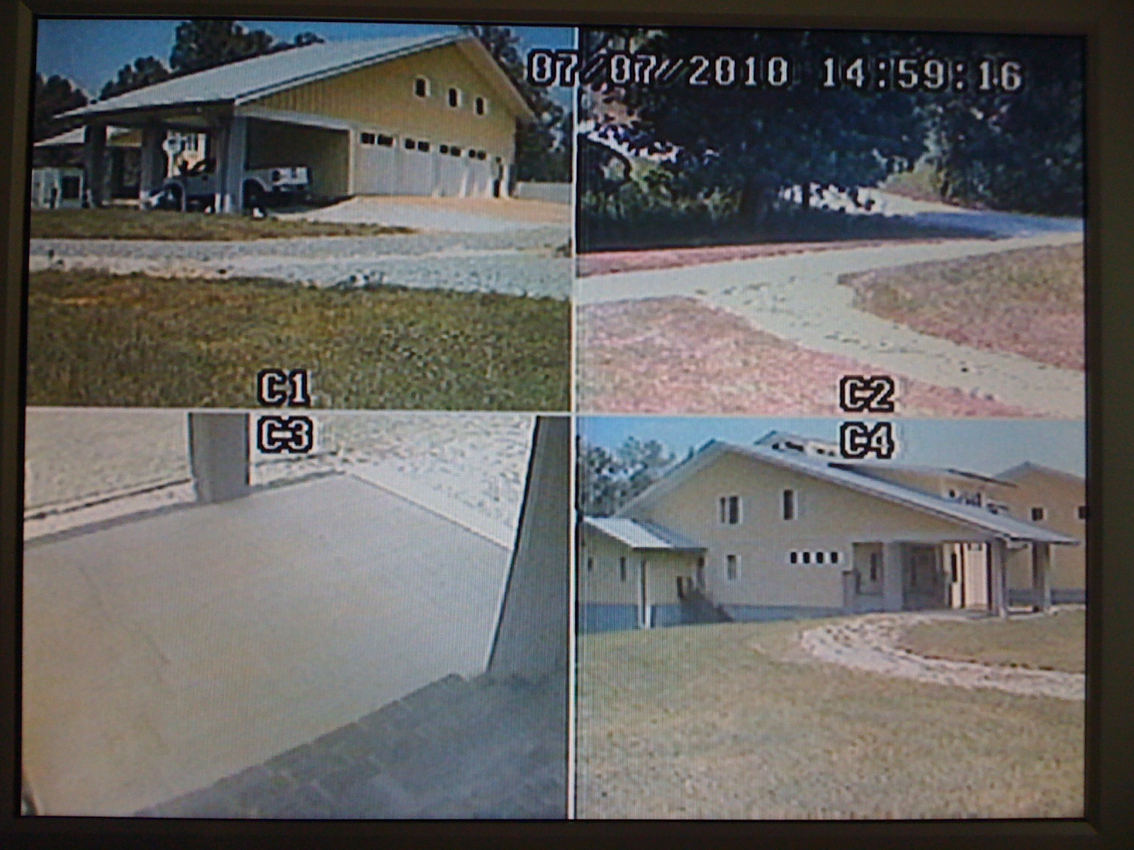

Let me touch on the subject of video cameras. I have one in the garage, one that shows you who's at the front door, and one in the basement. There are no cameras in the "people" part of the house. I also have cameras outside that look back at the house, but that's a lot of outside work. One of the most useful cameras is one I did not pre-wire for, but added later. It looks down the driveway. When the driveway sensor makes a noise, I can turn on a TV and look and see what's coming. So if there is a window with a good view down the driveway, a box high up by the window will let you add this feature.
It's a great feature. I added the cameras after we had been in the house for almost 2 years. I've attached a picture of a quad combiner that takes the two outside views of the house (people door and garage door), the people front porch, and the view down the driveway.
