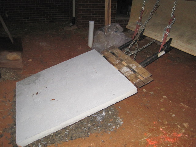

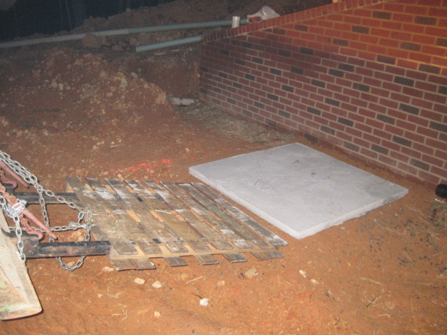

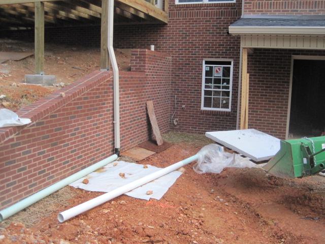

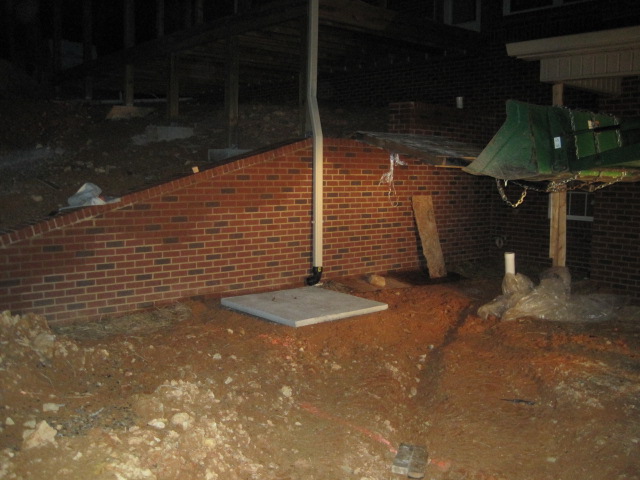

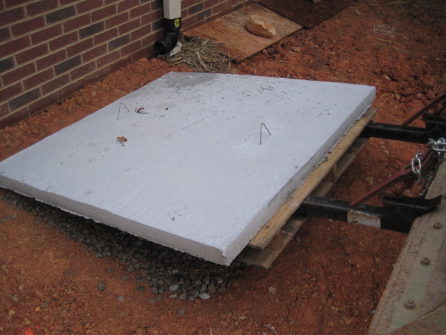

Wednesday evening I placed the concrete pad for the H&A unit in its spot. My wife picked it up from a pre-cast concrete store. I put the forks on the FEL and unloaded the pad from our pickup truck. The forks for the FEL really come in handy when you need them. It was a little tricky getting the concrete pad to slide off of the pallet with out the pallet sliding off the forks with the pad. I ended up chaining the pallet to the FEL.

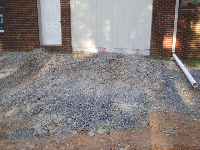

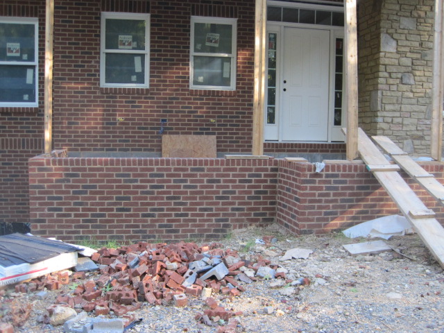

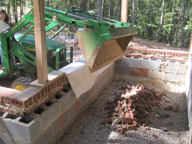

Today my wife and I worked on filling the front porch.
attachment.php

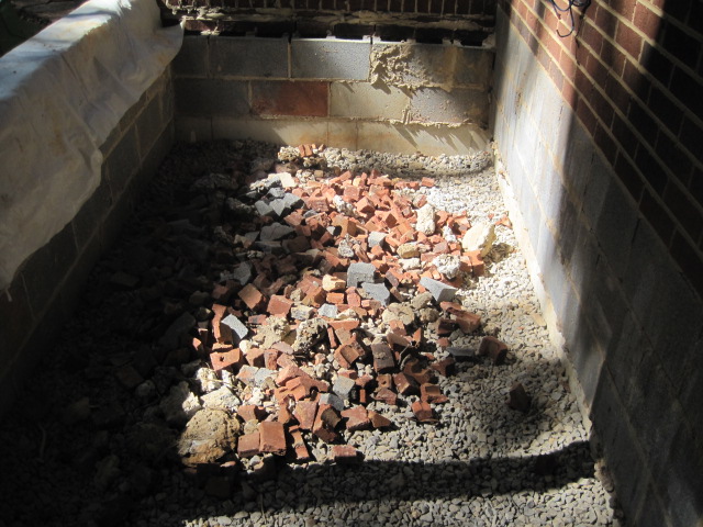

It surprised me when I looked at the porch a few weeks ago as to how much fill would be needed under the front porch. We decided to use a combination of brick debris and gravel as fill. I broke up all the bricks with a sledge hammer so they would pack well.

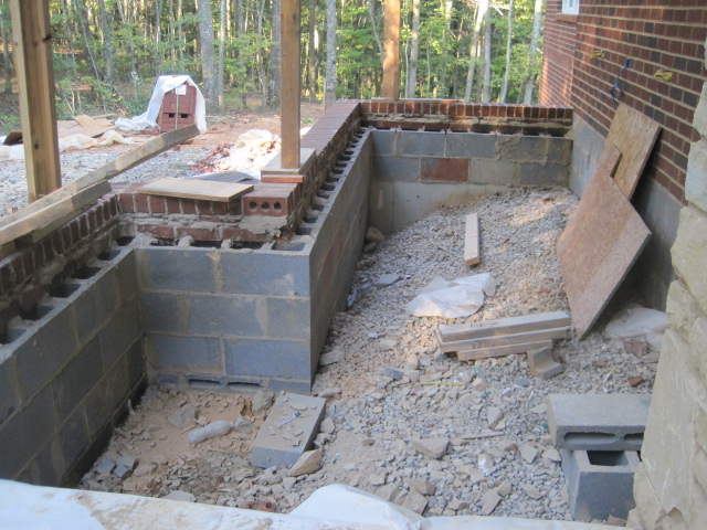

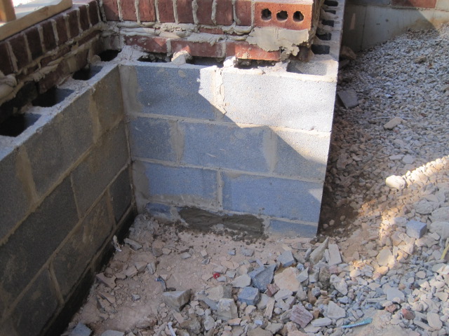

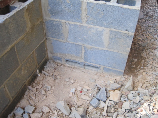

The first thing we had to do was to plug with mortar 3 spots where the brick crew laid 4 inch hollow blocks on their sides. We had solid 4 inch blocks and the brick crew new it. They should have used them. So we filled in 3 blocks with mortor to help make them stronger. Blocks sitting sidesways are not very strong.
We intended to ask the brick workers to fill these blocks with mortar when they came out to finish the brick at the back porch. Unfortunately we forgot to ask them so we had to do it ourselves.

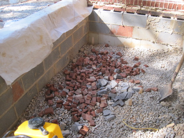

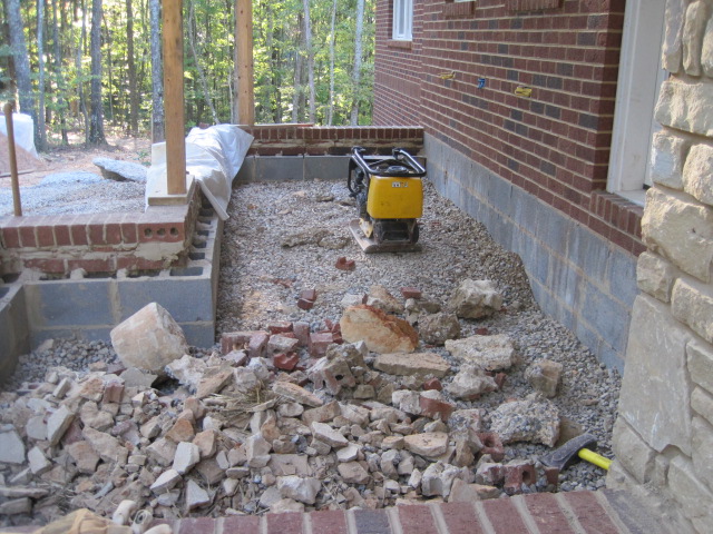

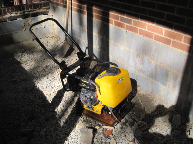

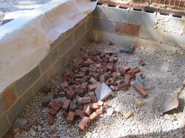

We rented a tamper to pack the fill so it will properly support the front porch slab. This thing worked extremely well and was easy to use.

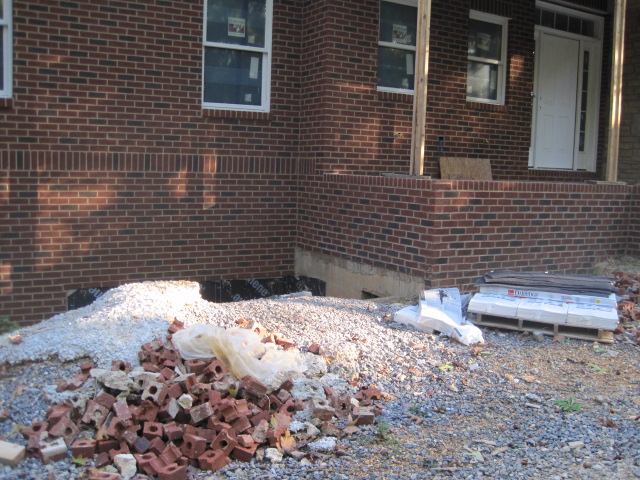

You can see the difference in the bricks before and after I broke them up with a sledge hammer. I'm not sure how important it was to break them up but we didn't that way to make sure. If the bricks weren't broken up, gravel might possibly seep into the holes in the bricks. I'm sure no contractor would go to the effort of breaking up the bricks - it might not be needed. However, we wanted to do everything we could to prevent the front porch slab from cracking.

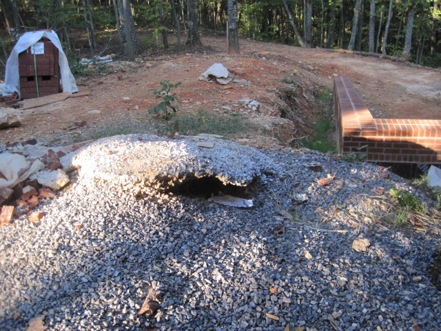

My wife did most of the tractor driving while I did most of the hand shoveling, breaking bricks, and tamping. We had one large piece of concrete waste that was too thick to break up. It didn't help that the concrete truck driver dumped his waste on top of a pile of gravel. So the concrete waste has a bunche of gravel in it to make it stronger.

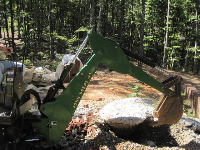

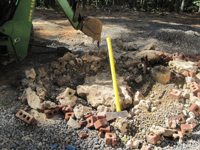

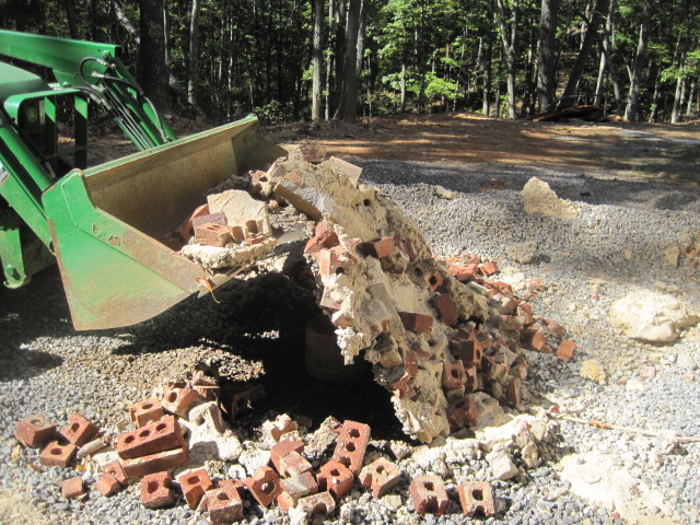

Here's a spot where the brick guys poured mortar waste on top of loose brick waste. I first tried to break up the brick/mortar slab with the back hoe but had marginal success. It turned out to be easier to break up the slab using my sledge hammer/mall.
