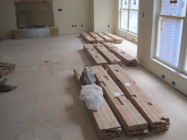

The hardwood flooring got delivered this week. There are stacks of flooring spread around the house. My wife bought a moisture detector off of E-Bay for $75. She made moisture measurements of the lumber the day it arrived.
