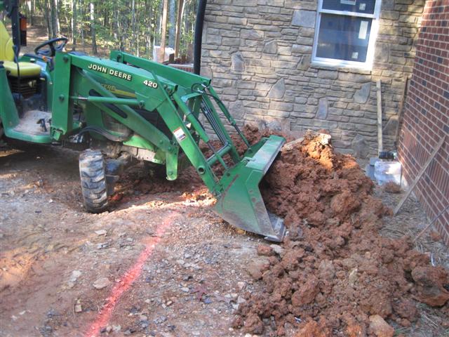

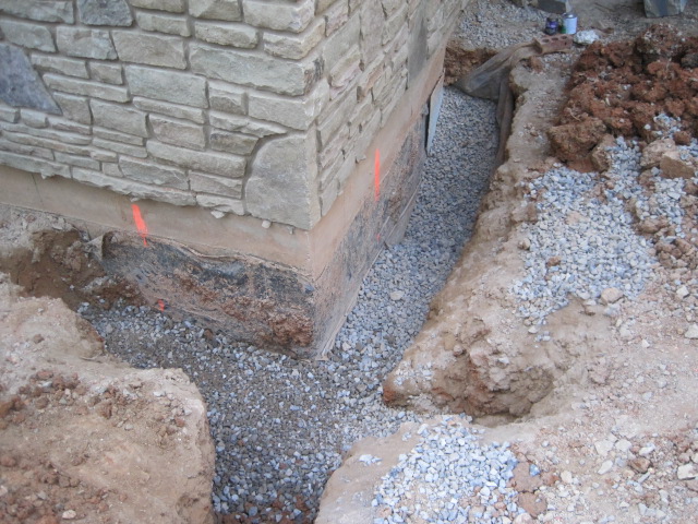

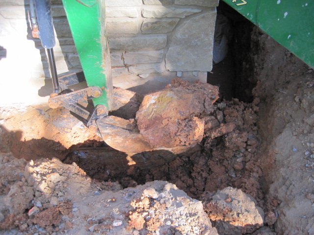

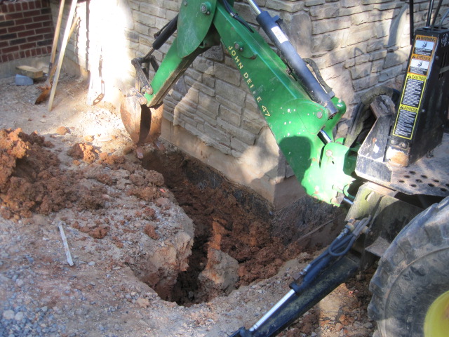

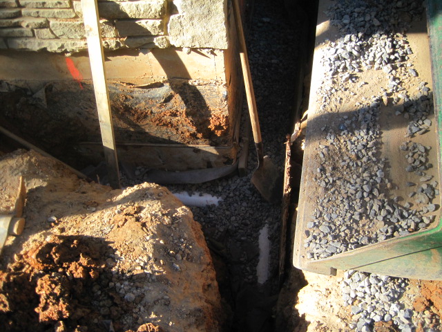

Sunday Digging
Sunday I finished the drain tile that goes below the water pipe and well wire entry points.
One of the tricky parts about digging is making sure you don't dig yourself into a corner. I had to think carefully about how to position the tractor and where to put the dirt so that the trench or dirt wouldn't end up in my way.
This job took me all weekend, full days on Saturday and Sunday. It's a big task that's been hanging over my head. It's nice to know it's done. This area is ready for the water pipe. We might add a little sand next to the house on top of the gravel to keep the pipe off the gravel.

Obed, on my water line I lined the trench with pea gravel, and then put a thin layer on top of the pipe once it was in the trench. I ran a 2" black PE pipe, but I need good flow and low pressure drop on the 800' line for my residential sprinkler system. I would take a loader bucket full of the pea gravel and spread/level by hand for the length of the trench. Same goal as you- keep the pipe off of sharp gravel and rocks.
cyril, dstig1: I like the epoxy the magnets idea. You'd still have to do a lot of trial and errors to get the gaps just right. dstig1, I was going to use and end mill for the drill and yes it would be a pain. Who knows what I would have done if the epoxy magnet idea had occurred to me ;).
