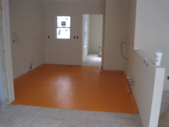

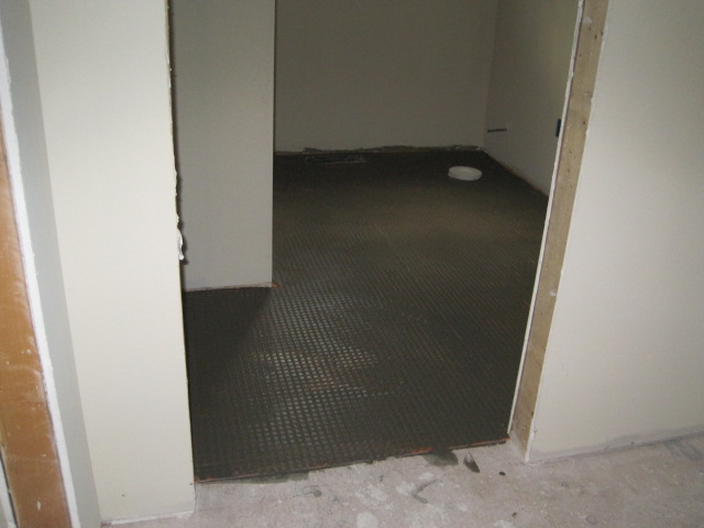

Tile Work Begins
The pictures show the underlayment being laid in the kitchen, master bath, and hall bath. The orange waferlike underlayment is called Ditra. On top of the Ditra, the tile guy laid the grey Thin-set, a type of mortar that provides the base for the tile.

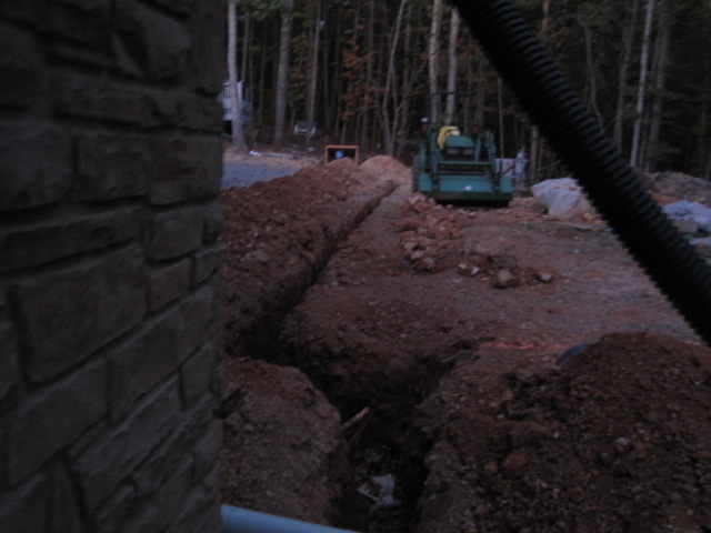

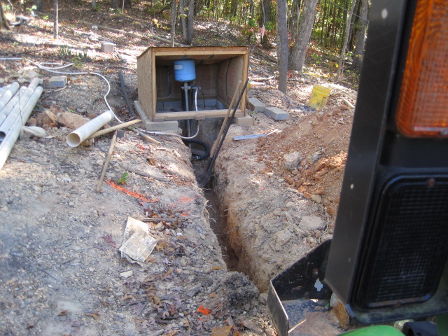

Friday Digging

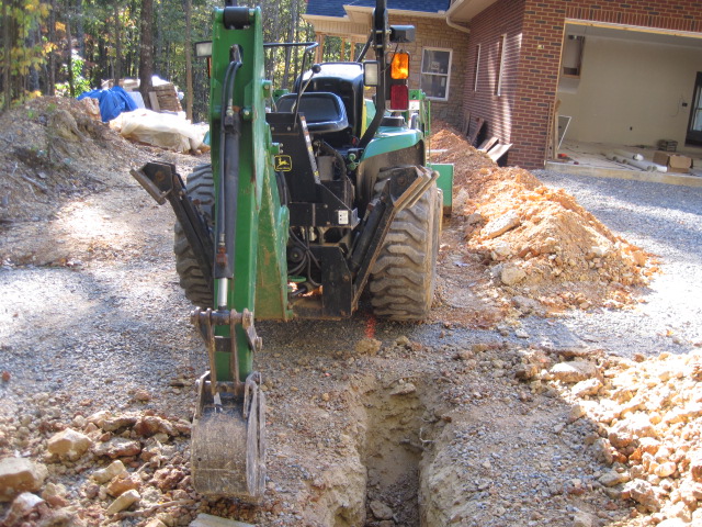

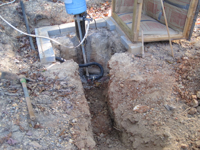

I took another vacation day from work Friday. With the days getting shorter, there's not enough daylight after work to get all the outdoor work done that I need to do. I needed to finish digging trench for the water line that will run from the well to the house. I left the end of the trench that crosses the driveway for last to minimize the amount of time that the driveway would be unavailable. I have to time things so that no big house supply deliveries are scheduled when the driveway can't be used.
I marked my trench with some paint. I hooked up some PVC pipe with 90 degree angles and used them as templates for marking the lines. I started digging at the well and dug along the painted lines until I met the rest of the trench that I had dug a few days ago.

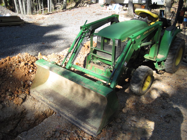

I had plenty of big rocks I excavated when digging the trench that I needed to dispose of. I dumped them below the culvert to use as rip-rap.

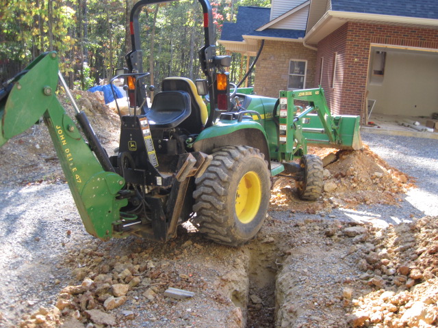

When I got close to the trench I had dug a few days earlier, I straddled it with the tractor while digging with the back hoe.
I've learned a trick for maneuvering the backhoe. In tight spaces, I lift the rear tires of the tractor off the ground using the back hoe. I then shift the rear of the tractor right or left while the back tires are off the ground.
attachment.php
In the picture above, the tractor was pointed straight down the trench before I repositioned the rear of the tractor using the backhoe. Doing so made it easy to back the tractor out of the tight position between the two trench ends.
