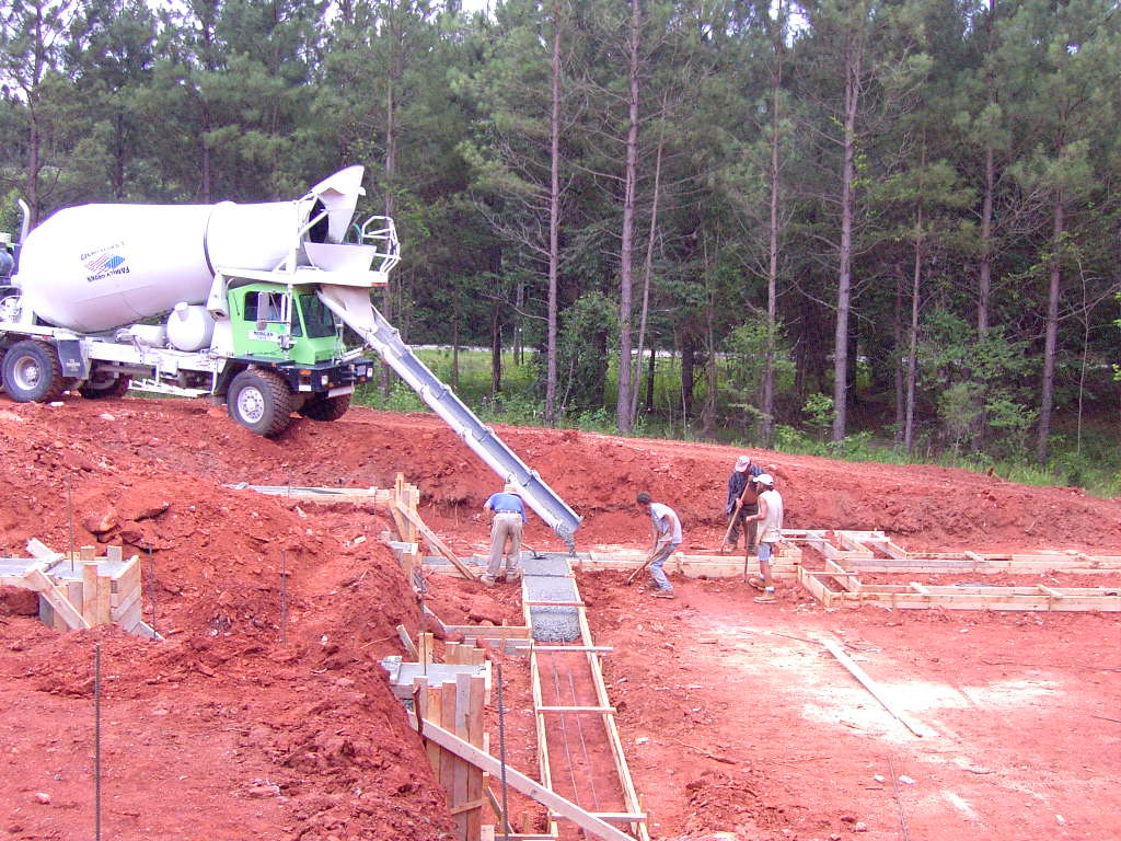

On post #89, you have pictures of your footings for the concrete walls. They have rebar in them, and it looks like pretty big rebar. Rebar is measured two ways, in eighths of an inch, or the first number in eighths of an inch. 5/8's rebar is #5 rebar. half inch, wich is 4/8's of an inch is #4 rebar.
Are you using the same people on your slab that did your walls? The walls look very good. They know what they are doing.
The slab is full of red flags. No rebar in the footings and no chairs under the wire make me nervous.

Here is a picture of the pour on our footings when we built our house ..If you look close in the trenches you will see the rebar and chairs that Eddie is mentioning..hope this helps..

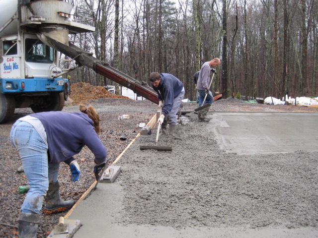

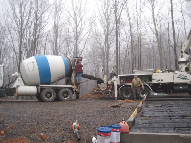

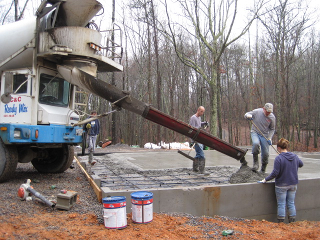

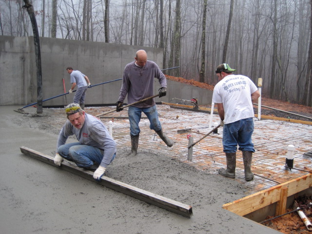

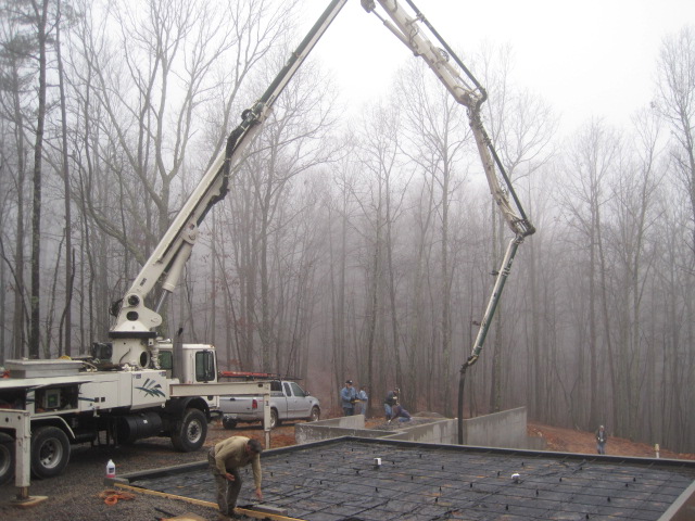

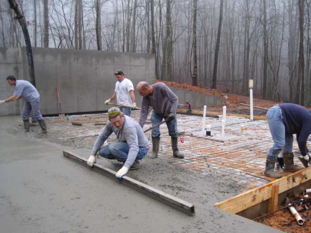

   / At Home In The Woods
#210

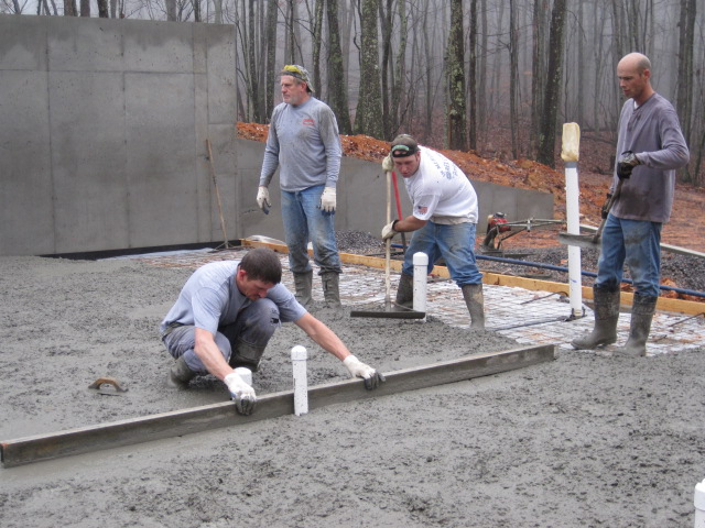

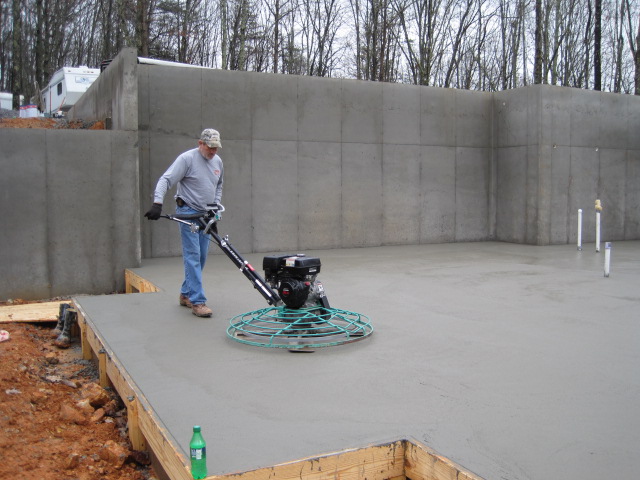

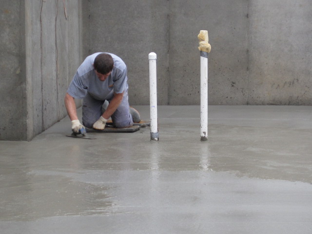

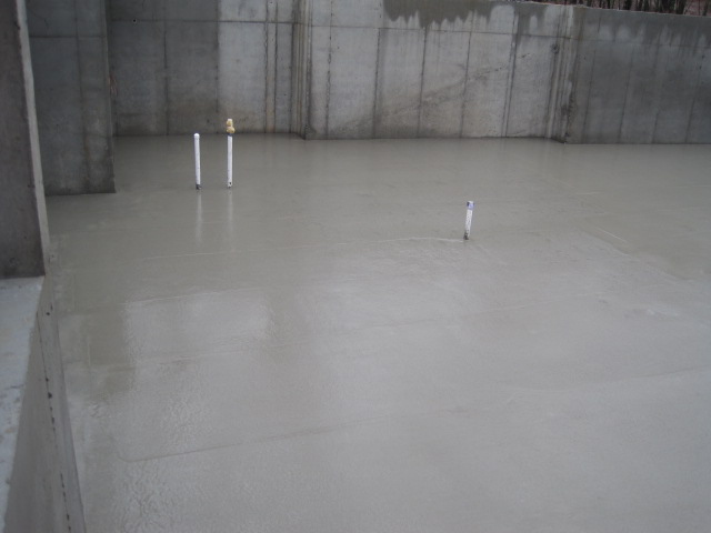

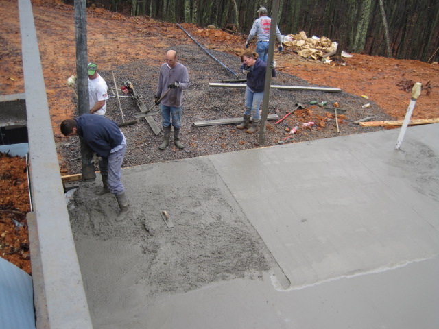

We finally poured the concrete slabs! I'm glad this part is over. The concrete pouring began yesterday morning at 8 AM and was all poured by lunch time. The finishing work continued until late Monday night. We got a warm dry spell Monday - Wednesday. The pictures show fog but no rain. Overall I was impressed with the concrete contractor and his crew. They were very hard working and gave attention to details.
