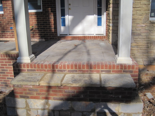

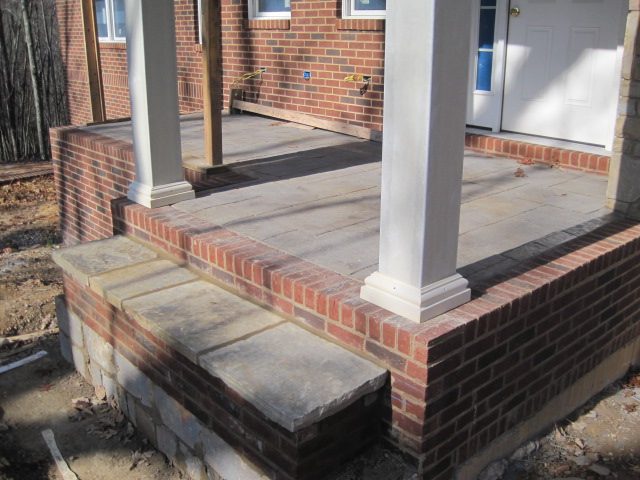

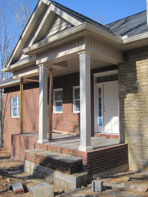

The front porch step and posts got installed. We had the stone guy install the step. He suggested that we cap the top of the step with stone. We liked the idea and went with it.

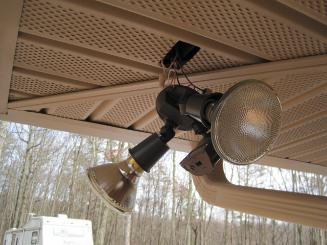

We have two fixtures outside the garage, one at each corner by the driveway. One of them has a motion detector. We put cheap floodlights around the house figuring we will eventually replace them with home automation floodlights. It didn't occur to me that both of the garage floodlight fixtures are on the same switch. Only having a motion detector on one of the switches wouldn't work. If we turned on the light switch, the fixture with the motion detector would stay turned off unless activated by motion. However, the other fixture would stay on all the time.
attachment.php
In consequence, I re-wired the fixture with the motion detector so that it would control both fixtures. The gutter downspout blocks the motion detector a little but it still seems to work well enough. Now we can walk outside our camper and the garage floodlights will light up. Yay!

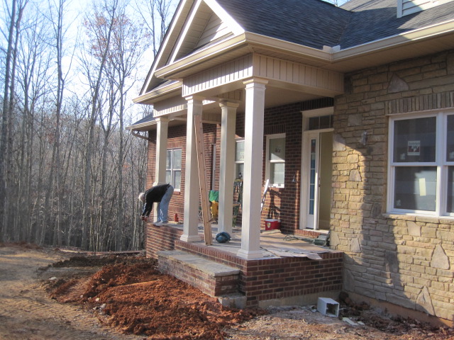

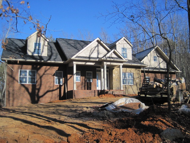

Here are pictures of the front porch with the new posts.
attachment.php
I was surprised at how much the posts changed the looks of the house. My wife got 8" square fiberglass posts. She didn't like the smaller posts as much. Now that I see how the bigger posts look, I'm glad we got the bigger ones.
