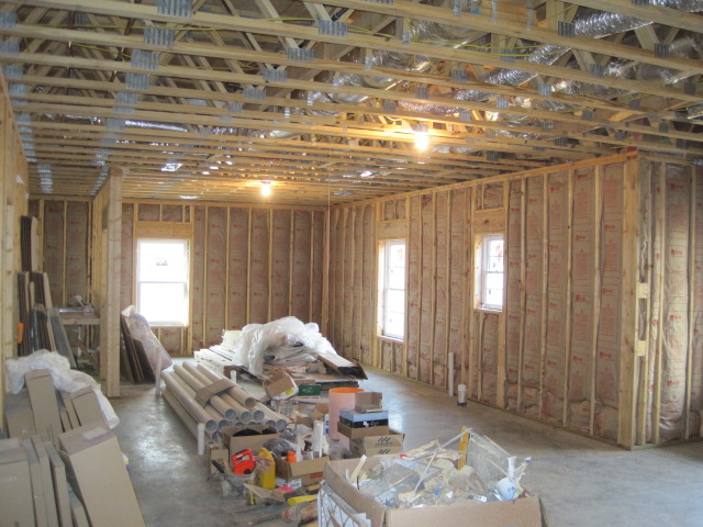

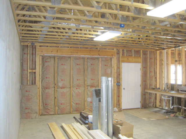

We have forecasts of a winter storm coming tomorrow then it's supposed to turn very cold with lows of 10 degrees Monday and Tuesday nights. We'll have to keep the cabinet doors open to get heat to our water lines and drip water but that still might not be enough to prevent freezing. The highs are predicted to be 25 degrees which doesn't help thawing the lines. I'll dump the black (sewage) tank in the camper tomorrow before the temp is supposed to drop. I hope the heating pad under the black tank will keep the tank thawed but don't know if it will be enough for those cold temps. Hopefully this is the last winter I will have to be concerned about cold weather.
We got insulation installed in the basement of our house on Thursday, just in time for these cold temps. I put a jug of water in the basement in the corner that is most like to be the coldest spot in the basement. I'm curious if the water will freeze. The gas has not been hooked up to the furnace so we only have the heat pump in the house for heat. I don't know if the heat pump will be able to keep up it the upcoming cold temps.
Obed

Obed,
I am a little farther south of you.. (30 miles south of Asheville, NC) and I have a heat pump..
It did not keep up last week...
and we then found out the emergency heat strips in the unit were bad...
Do you have heat strips in the air handler?
We have a 20KW heat strip.. and I think our house is about the same size as yours.
I have been thinking about what it would cost to add a gas furnace to our heat pump.... but we have to go with Propane as there is no gas service in this part of town....
Let us know how you make out!
