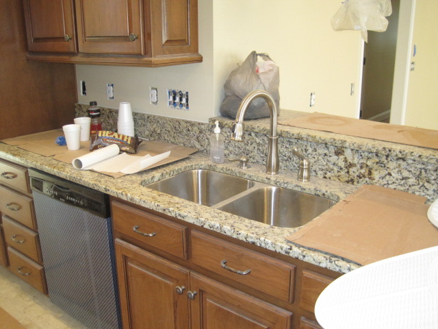

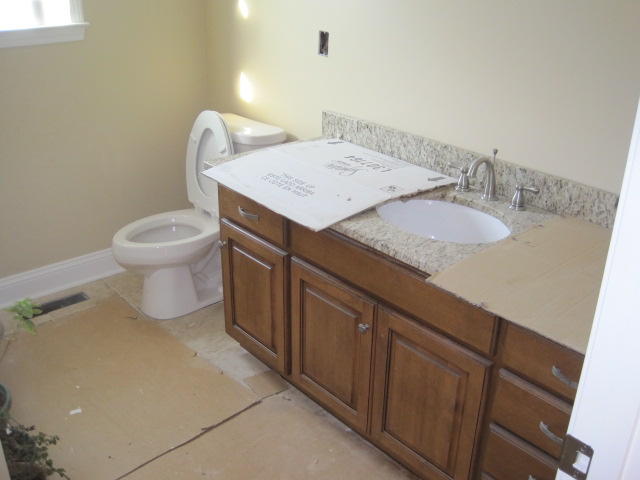

On Wed. the plumber finished his work and got his final payment.

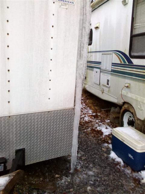

Wednesday night we got the forecasted freezing rain. I really needed to get to work to get a new laptop so I could start configuring it in hopes of salvaging some of my upcoming vacation. I had parked my car at the bottom of the steep hill that runs to our house so that I could get to work on Thursday. I put some plastic over the driver's door so it wouldn't freeze shut.

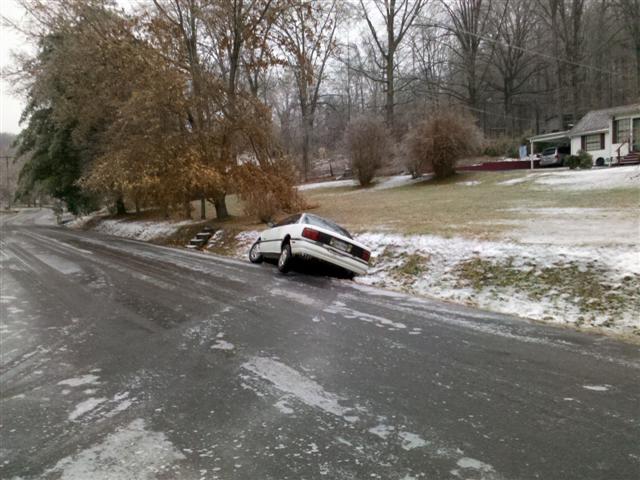

Road conditions were slick but seemed manageable. However, about a 1/2 mile from my house, as I went over a hill I saw that the road was solid ice on the downhill slope. I wasn't going fast but there was no way to stop. As I slid down the hill, I knew I couldn't stop so I then started looking for the least damaging thing I could try to run into. I slid through the stop sign and ran into the ditch across the intersecting street. My car appeared undamaged but I had taken out a mailbox.
There was no way to get the car out of the ditch until the ice thawed. I talked to the owners of the mailbox and told them I would repair it on Saturday. So I hiked through the woods back home. Late in the afternoon after the ice had thawed, my wife and I pulled my car out of the ditch using my pickup truck and a chain.

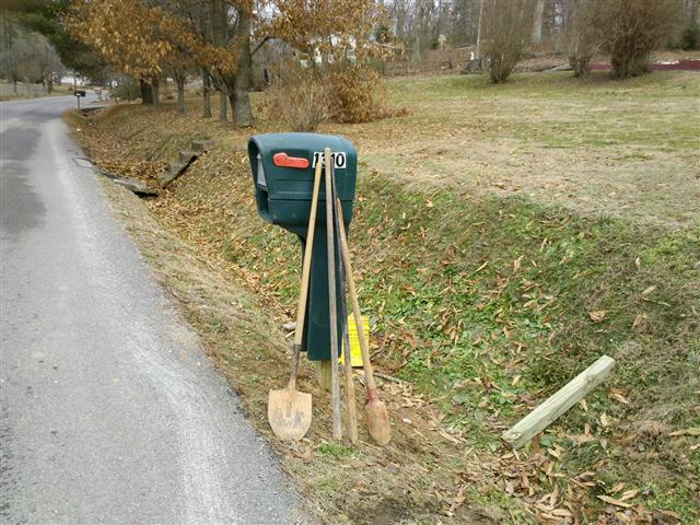

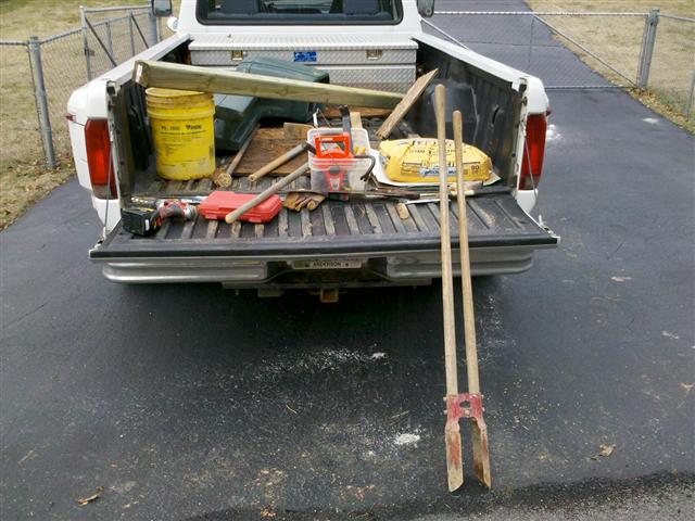

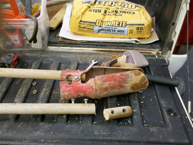

On Saturday I replaced the mailbox post and reattached the mailbox. When I had dug the post hole 18" deep, I hit a large rock. I ended up chipping pieces off the rock with my digging bar until I could make the post hole 24" deep. Also, while digging the post hole, one of the wooden handles on my post hole diggers cracked where it was bolted onto the diggers. So I cut off 4" of the handle, drilled a couple holes through the remaining handle and bolted the shortened handle onto the post hole diggers. Fortunately, I had all the tools I needed with me and was able to finish the job in one trip.

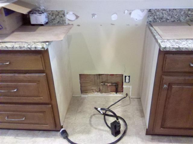

Last week we returned the duel fuel stove (gas range/electric oven) we had ordered and picked up from Sears. My wife didn't like the way the burners were arranged on the stove. There doesn't seem to be a standard for gas stoves regarding where the gas line connects to the stove. You really need to know which stove you will use before the gas line is run to the kitchen. Yes that seems extremely stupid but that is what we have found out. If we had kept the stove we purchased, the gas line behind the stove would have needed to be moved or it would interfere with the stove.
My wife decided that she didn't like having to move the gas line every time we replace stove so she had the H&A guy reroute the gas line so that it is recessed in the wall behind the stove. My wife is going to build a metal box in the wall to house the H&A line. The picture shows the she made in the wall and shows the gas line after it recessed in the wall.
The duel fuel stoves are unbelievably expensive; the one we returned was $1800. My inlaws have given us the electric stove they recently replaced; we will use it until we get around to buying another stove. When you're spending $1800, you really want to get something you like rather than something you can "live with". If we wait for sales, we can probably get an all gas stove (range and oven combined) and a separate electric wall oven for the price of one duel fuel stove. We have a spot in the cabinets where we can put a wall oven if and when we decide to buy one.
