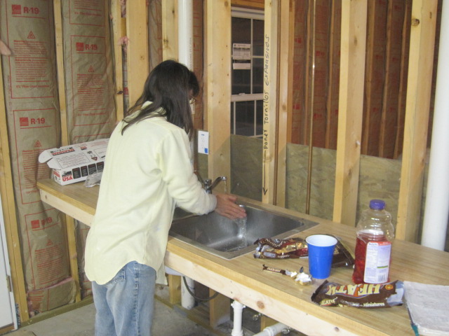

My wife is building shelves for the linen closets in the hallway, hall bath, and master bath and for the small kitchen pantry. She decided to build the shelves out of plywood and finish them with polyurethane. She is attaching a piece of trim to the front of each shelf to hide the edge of the plywood. She temporarilly attached screws in the ends of the shelves in order to hang the shelves from the ceiling as the polyurethane dries. The shelves shown hanging in the picture do not yet have polyurethane applied to them.
We went with plywood because we don't really care for the wire shelving systems; in addition the wire shelves are expensive. All our shelves will be adjustable.
We are enjoying having a basement available for this kind of project. Although it's chilly outside, the basement is fairly warm and is much warmer than the main floor garage. My wife is making use of our slop sink in the basement to wash her hands. I'm still amazed that the sink, faucet, and countertop were free.
