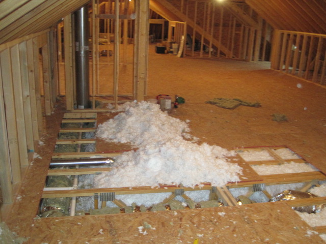

This past weekend my wife built a really hot fire using small dry wood. The fireplace got so hot that the heat duct that runs from the fireplace to the hallway ceiling got very warm and set off the smoke detectors. I went into the attic and unscrewed a piece of OSB so I could inspect the b-vent double-walled duct that runs to the hallway ceiling. The insulation company did not do a great job installing the rockwool around the b-vent duct so their was blown insulation touching the hot duct. I believe the warm insulation touching the duct caused the smoke detectors to go off.
Obed
Today my wife and I worked on a miserable task.
attachment.php
We re-did the rockwool around the b-vent duct that supplies heat from the fireplace to the hallway ceiling outside of the bedrooms. Please note that this duct is not a chimney duct. The rockwool is the green material shown in the pictures that surrounds the heat zone duct running from the fireplace. The purpose of the rockwool is to create a physical barrier between the potentially hot duct and any combustible material like the blown insullation. The insulation company had loosely placed the rockwool around the duct but did not tape it or strap it around the duct resulting in places where the insulation was touching the b-vent duct through the open gaps in the rockwool. BAD!
We removed all the rockwool, cleaned the insulation off the inside surface of the rockwool, and reinstalled the rockwool. Originally, we were using foil tape to run around the outside of rockwool to secure the rockwool. However, using the tape was a pain. So I went down to the hardware store and bought some rebar tie-wire. We used the tie-wire to wrap around the rockwool and secure it. The job took a few hours. My hands and arms are very itchy from working in the insulation. However, it was a job that needed doing and I didn't trust the "professionals" to come back and do it correctly and safely.

Glad to see you took care of this possible probelm sorry it wasn't done right to begin with!! :( At least now you know it's done correctly and you and your family can rest easier knowing there is less of a fire danger! :thumbsup:

Funny how often you catch yourself saying that after this project, isn't it? All too common... :confused2:
That just sounds so weird to hear said even if it is true.:confused2:
I agree.
