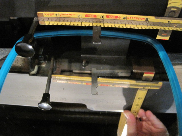

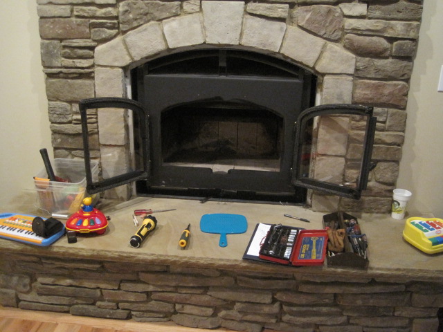

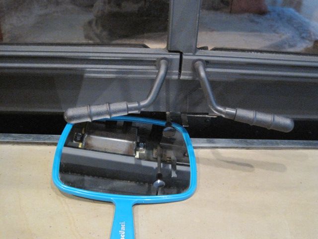

Fireplace Update
A week ago the fireplace guy came out to our house. This is the ongoing question we are having regarding whether or not our QuadraFire high efficiency fireplace is working correctly. I showed him how the operation of our Automatic Combustion Control (ACC) did not appear to correspond to the description in the manual. I showed him how when you slide the control from the fully closed position, the first 1" or more of sliding the control lever does absolutely nothing to open the cumbustion air hole, contrary to what the manual states. The fireplace store guy contacted his engineer guy at QuadraFire who said that the manual has not been updated after a manufacturing change.
attachment.php
When the store rep was out our house, he noticed the baffle located at the top of our fireplace was a couple inches out of position. He repositioned the baffle to where it should be. The engineer told the store rep that half the calls they get about poor fireplace operation results from the baffle being incorrectly positioned. The baffle at the top of the firebox greatly affects the draft of the fireplace and can seriously adversely affect how well the fireplace drafts and burns.
The store rep told us we should burn a fire now that the baffle has been repositioned. He recommends that we do that now rather than in the fall when they commonly are very busy and may have a difficult time getting out to our house if we need help. Our outdoor temperatures are running between the low 60s at night to the upper 80s and sometimes 90 during the day. I can't say that closing our windows and burning a fire in the fireplace enthuses me at this time. It's not like we could build a short burning fire. We would have to burn the fire for several hours so that we have a good bed of coals to verify whether or not the fire is burning well.
I have to say that anything the manufacturer tells us at this point I listen to with a "Buyer Beware" perspective. I still have concerns that our fireplace may have a manufacturing defect. I'll have to talk to my wife and see what we want to do. We do need to build a test fire now that the baffle has been repositioned to see if our fire will now burn better with the doors closed.

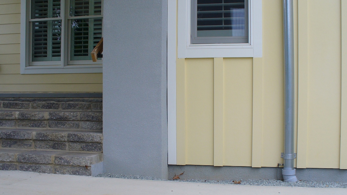

On your PVC gutter drain pipes with clean-outs, you might want to think about spray painted them to reduce the visual impact. I did that with mine. Put a big piece of cardboard to protect the house and spray the pipe with some color that is close to the background color of the house/brick (cement in my case).
The first pix is a close-up. The gravel settled a bit so you can see the difference between the natural white PVC and the painted on this background. Second pix is a "normal people view" and not having that white blob of pipe there helps a lot.
It looks marginal close up, but from "normal" viewing distance it makes quite a difference. And I suppose if you really hated it, you could spray paint it back to white :laughing:.

Is this where we are suppose to tell you that the downspout in the second pic looks crooked?;)
Nice stairs though. I really like the look of the stone.:thumbsup:

That is a good idea. If I painted mine, I'd probably paint them the same beige color as the downspouts.
