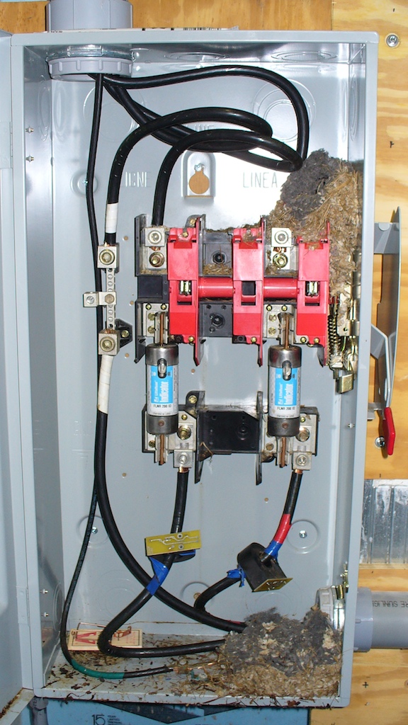

I didn't seal the end of the conduit that brought power in from my generator. One day in the basement I smelled "that smell". The picture is what I found. I had to take the switch apart and clean it all. I replaced the fuses in case they got anything in them. What a mess... I still have to take the transfer switch apart, it has one area that got peed on. I ordered the conductive grease for that, so that should happen soon. I'll also check and grease the moving part of the disconnect switch.
Also had a mouse nibble on the seal of a garage door, and so I bent up and glued in some aluminum flashing at the bottom. If that didn't work, I'd bolt the metal to the plastic seal with some small #4 screws.
Part of moving into a new house is letting the mice show you the areas you forgot to seal up all the way...:eek:
