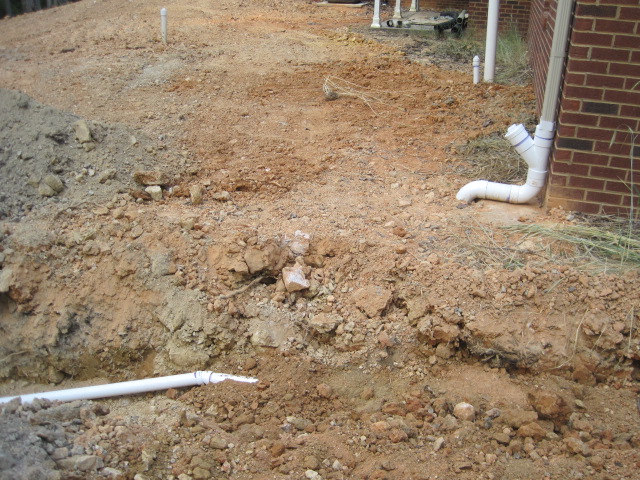

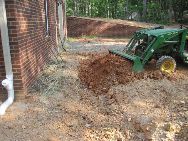

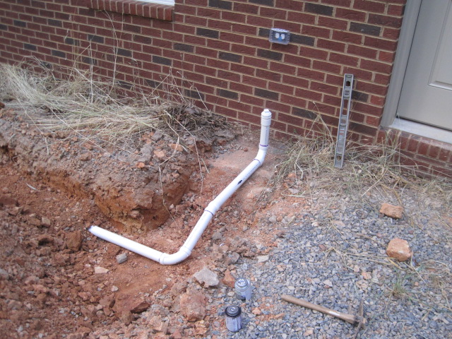

Friday and Saturday after work I installed a drain line for the basement. The grading contractor dug the trench with his excavator. The first step was to put to piping pieces together to make sure I had the right connectors to make all the angles. I got to use my saw-zaw to cut the pipes. The saw-zaw is a toy I was able to talk my wife into letting me buy while we were building the house. It's much easier cutting the PVC pipes with the saw-zaw than with the hacksaw the way I used to do it.
Like normal I had extra rocks. I dumped the rocks near the culvert where I will use them as rip rap after our grading job is finished. I had to backfill much of the trench by hand to keep the rocks away from the pipe. As such, backfilling the trench took a lot longer than I expected. There was a pile of dirt below the end of the pipe at the outlet end. I couldn't get to that pile of dirt with my tractor because of the steepness. So I spent about 45 minutes throwing dirt with my hand shovel up the hill into the trench.
I stubbed out the end of the pipe at the wall of the house. The pipe does not connect to anything yet. I plan to hook the pipe to our slop sink in the basement. I will need to drill a hole through the brick above grade to run the pipe through the wall higher than the height of our basement concrete slab. If I had it to do over, I would have put a French drain at the outlet end of the pipe to keep the water from running directly onto the ground. That would be a little more environmentally friendly. However, I didn't think about it until someone I talked to on Sunday mentioned using a French drain.
