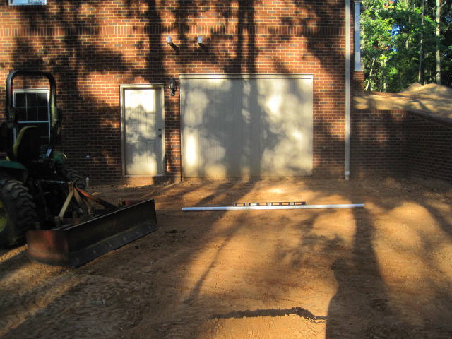

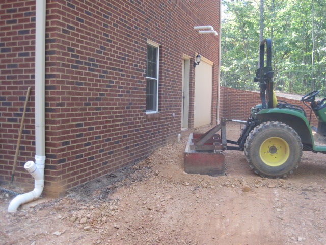

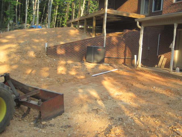

I worked my way around the house doing the fine-tune grading the red clay starting with the front side (south), then the basement garage side (west), and last the back yard (north). The east side of the house is where the upstairs garage is located and was saved for last.
I made sure the grade fell away from the house with at least 6"/10 feet using my PVC pipe and level. It is a crude but simple and effective way to measure the grade. My level has a tick mark on the bubble glass that shows a 2 1/2" per foot drop that can be used to measure septic pipe drops. I just estimate the drop based on where the bubble sits in the glass.

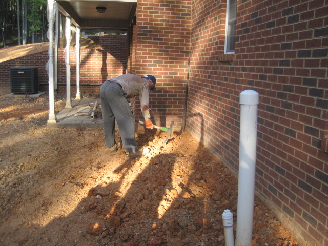

I've had trouble with the contractor dumping too much dirt next to the house this entire job. I can't seem to get it through to him that the dirt, including the topsoil, cannot be any higher than 6" below the framing in the walls. I have removed with my box blade many loads of dirt from up close to the house and dragged them to my two spoils areas in the woods. It is much easier for him to dump dirt and grade the loose dirt than to have to cut the existing hard packed dirt. Also, dumping the loose dirt around the house prevents the contractor from having to cart off as many loads to the woods. I'm a little sore about this issue.
Some areas where he dumped dirt too high against the house, I had to remove by hand with a maddock and shovel because I couldn't get to it with the BB. In fairness, there's no way I could expect the contractor to spend the amount of time fine-tuning our grading as I would. They'd never make any money that way.

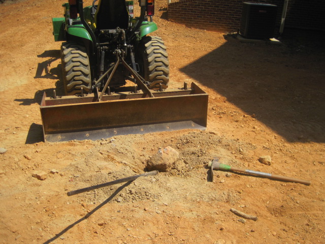

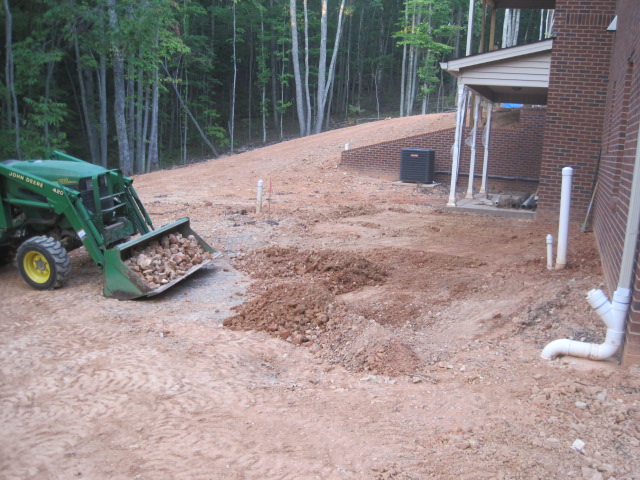

My wife and I raked up a lot of the loose rocks around the yard. I put them in the FEL and hauled them away. I also pryed out of the ground with my digging bar quite a few volleyball sized or larger rocks.
