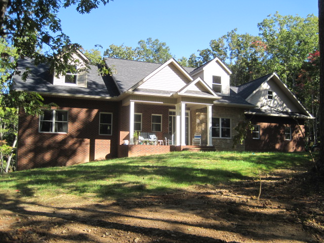

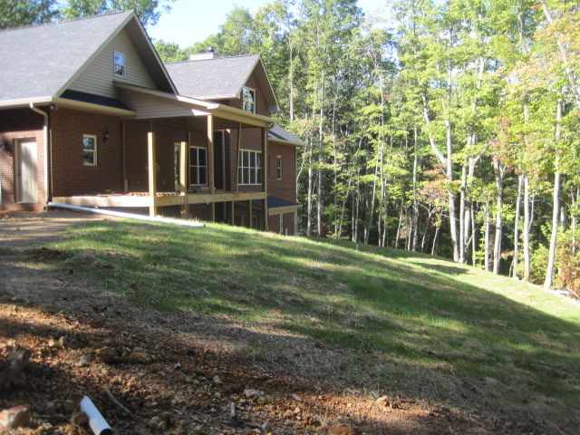

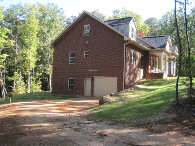

We Have Grass!
attachment.php
It took two weeks from seeding for the grass to look like this. I was rather surprised that it grew so quickly. We have a mixture of three types of fescue grass. We got several good days of rain right after we sowed the grass so that really helped. We've also been watering the lawn.

Looking good Obed. Now you will have another chore around the house - cutting the lawn. I think with your luck the Mrs. will be the one that cuts the grass. :)

Somehow, I don't think I will be that lucky. However, I expect I will be lucky enough that she will tend the garden.:thumbsup:
I have made efforts to minimize the amount of grass trimming that will need to be done. I'm trying to get most things so that I can mow right up against them with the riding lawn mower. The other day my wife mentioned something about landscape timbers or something similar beside one of the future landscaping beds around the house. I asked her who was going to trim the grass growing up against the timbers because I wasn't going to do it. The landscaping timbers idea quickly vanished.

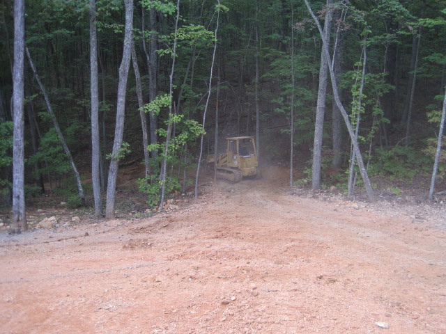

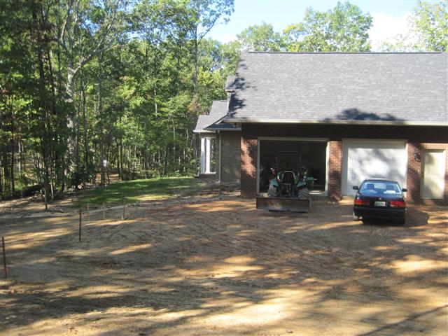

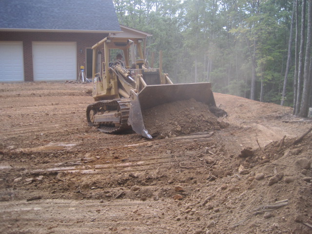

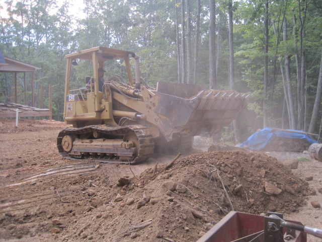

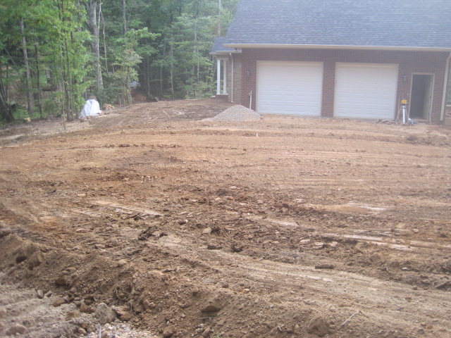

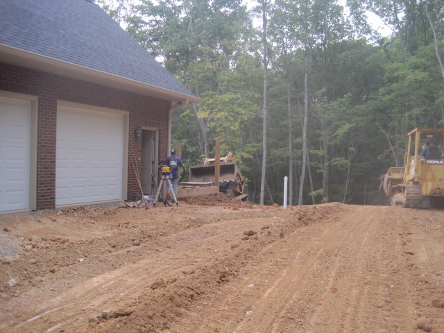

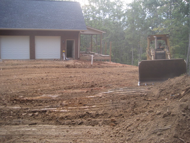

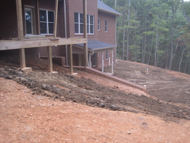

On Sept. 14, topsoil was roughly spread around the yard. The topsoil was somewhat damp and needed to dry out before it could be finish graded. As mentioned here, we didn't have to buy any topsoil. The skid steer hauled dirt from the pile in the garden clearing and spread it around the house. The quality of the topsoil looked very good and there was plenty of it.
The same day, the contractor started grading the parking pad at the main floor garage. During the original house escavation, the contractor (the same one who is doing the current grading work) spread out some of the red dirt from the basement onto the parking pad. He wasn't supposed to do that but he did. I had been very explicit about not adding fill dirt under the garage concrete and under the outside parking pad. However, I had so much going on at the time with the house buidling job, I didn't have the time and energy to fight about the parking pad.
Unfortunately, at that time, not only did the contractor add dirt to the parking pad but the grade sloped such that water drained toward the garage instead of away from it. At the time, I did mention the slope issue to the contractor but he claimed it did not slope that direction. I didn't have a good way to measure the slope back then so didn't pursue it even though the slope looked to my eyes to be the wrong. It turned out that I was correct; the grade sloped the wrong direction. So now, over a year and a half later, I am paying him again to remove the dirt that he shouldn't have added in the first place. The parking pad with the embedded gravel in the red clay was impossible to dig up with my little tractor.

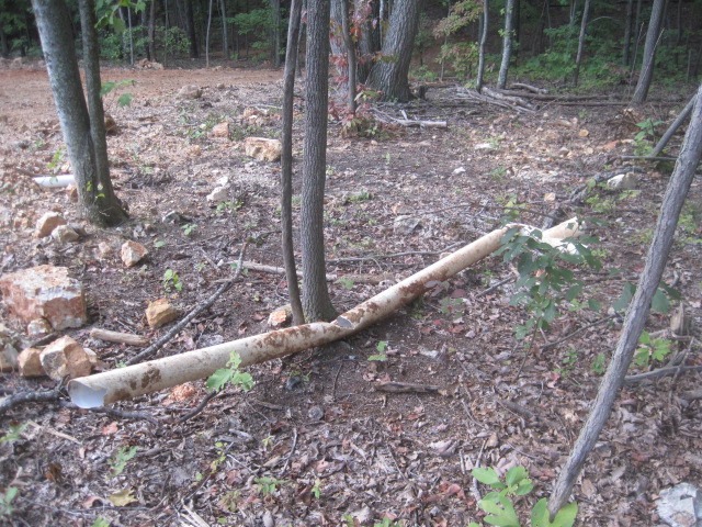

Back to the current job, at mid-afternoon the contractor, under the direction of my wife, accidentally dug up an underground drain pipe he had installed for one of our rain gutter downspouts. That's something we had to fix a few days later.

Obed -
Wow, the place looks completely different with grass!! Really looks good!
As for the "edging".....don't think you can avoid it. We're up against the same thing. 2 essential choices.....landscape timbers, solid plastic/metal short fencing, i.e. "bordering". Or, you can choose not to use these, but then have to edge the grass directly downward into the dirt creating the edge.
We've chose to use the solid roll of black edging, used it on the last house with good results. Pain to get it in, but it's a good border between grass and flower/shrub beds.
As for the dirt work.....did you have a chat with the contractor? Mention to him he's undoing his work you didn't want him to in the beginning? And about breaking the drain line? Seems to me he's charging you twice for the same job, and threw in a little damaged line to boot.....perhaps some re-negotiation on his fees would be in order?

Frank, I completely missed the grass photos until reading your post. Then, I went back and looked. I agree with you completely. Obed's grass looks wonderful. He did a great job getting it up and hopefully if will hold onto his soil.

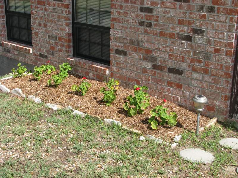

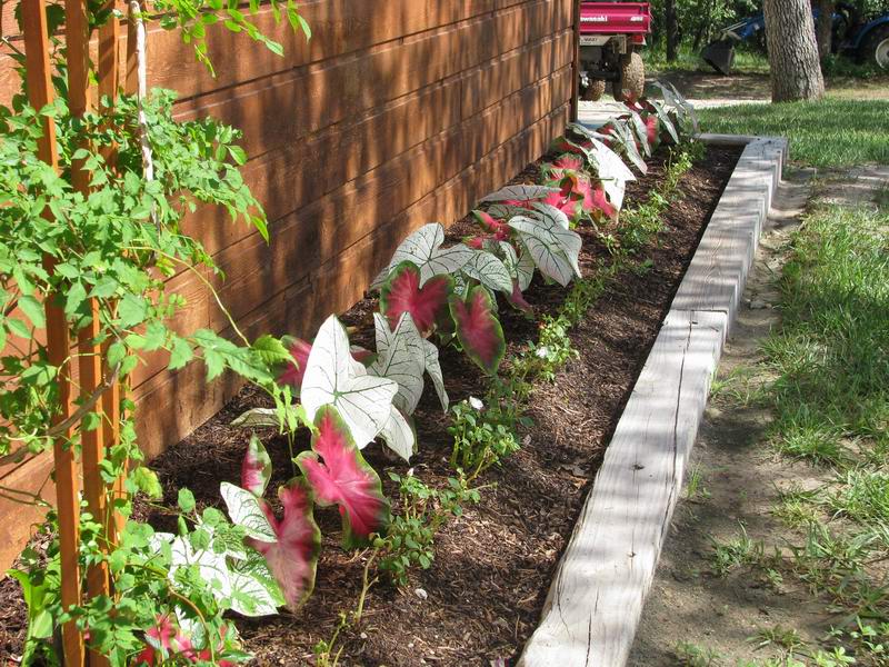

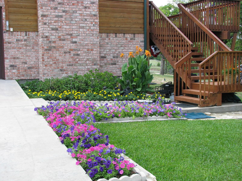

EDIT: On the subject of flower beds, I've had mixed success with different types of materials used for borders. The very best I've come up with is a 6" wide timber around the edges of the flowerbed and up maybe 1" to 2" above the ground level. I've used 6x6 posts made for ground contact and 6x6 timbers cut from telephone poles (my latest and best). These are not very dressy, but you can add concrete scalloped borders inside to improve the look as in the 2nd photo below. Where the scalloped sections will get grass if they are the only thing used, with the timber there is no danger of grass growing into them. What I find is that grass may jump over a border that is narrow, but a 6" border provides a great barrier for most grasses. On mine, I can actually put my mowers deck over the top of the timber and trim grass without using a string trimmer, but it looks much better when I do use a string trimmer.

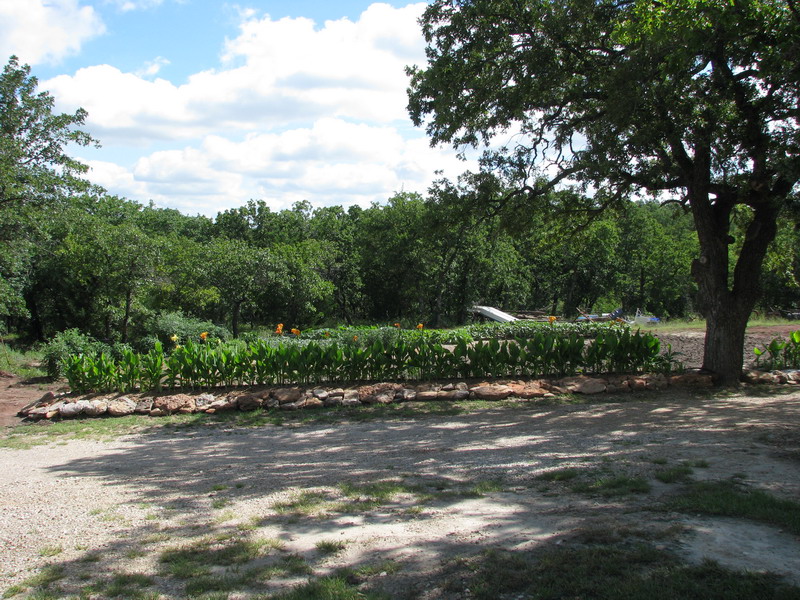

Another way to do a border is with native stones. You need to cover the ground beneath the stones with landscape cloth to help control grass. My long bed of iris and cannas is an example. As with any border of this type, you'll eventually get weeds. However in the last photo below, you can see where I used flat rocks to make a border and the grass just grew right between the rocks so that this always was a big maintenance job in the summer.
