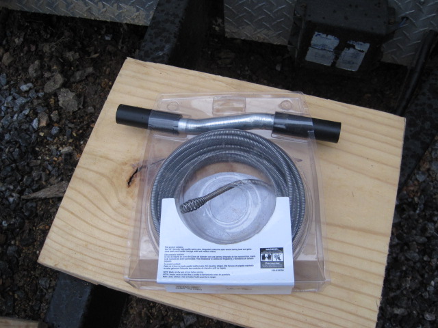

Clogged Kitchen Drain
Tuesday night around 9 PM the camper's kitchen sink drain completely clogged. It had been gradually getting worse for a few weeks but finally became unusable. The kitchen sink has a removable trap. What a great idea. You just unscrew by-hand the nuts that connect each of the threaded ends of the trap. So, I removed the trap thinking that I could clean the gunk out of it and be done. No such luck. The trap did have lots of gunk in it by that didn't unclog the drain. So I then ran a thin coat-hanger through the drain to no avail. Next I pushed a 3/8 inch clear plastic hose into the drain. This attempt also failed. So I took a sewer snake, climbed up on the roof of the camper and ran the snake through the roof vent. No luck here either. The snake was too large to negotiate the 90 degree drain pipe turns. So my wife washed our dishes in the bathroom bathtub. Not fun.
The next day, I bought the 25' long wire coil snake shown in the picture at a True Value hardware store just 5 minutes away. I love True Value stores. I can get in and out in 5 minutes. Help is always easy to find. I could never get in and out of a Lowes or Home Depot in 5 minutes.
That evening, I was able to unclog the drain. Unclogging the drain gave me some momentary happiness.

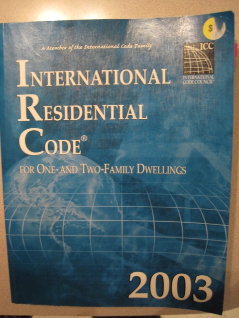

I had a talk with the construction manager today. I offered him a bonus if he meets some objectives of mine that I had listed on a sheet of paper. The more objectives he meets, the better will be his bonus.
We also talked about the basement framing. We are going to add additional jack studs around the basement windows and doors to meet the IRC 2003 (Internation Residential Code) specs for walls that support two center-bearing floors. IRC 2003 is the code book used by our county. For our house, the table in the code book specifies that we must have 2 jack studs on each side of our basement doors and windows (each opening is approx. 3 feet wide).
