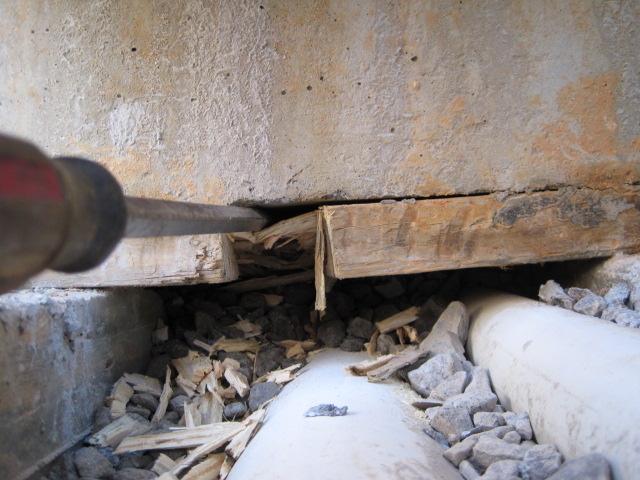

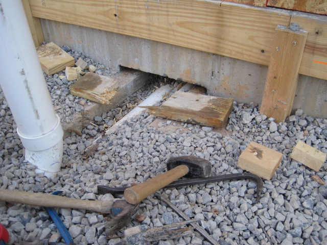

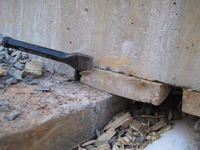

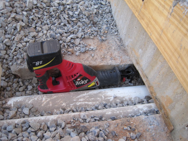

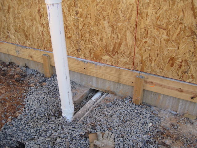

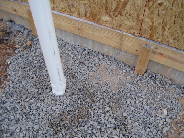

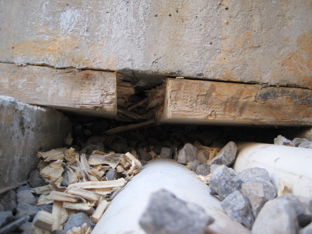

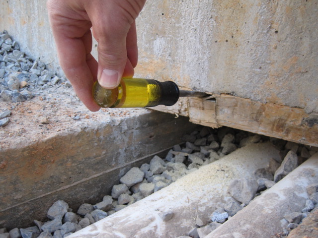

A sleeve was created in the foundation for the drain lines. A board used for making the sleeve was left in the concrete. I removed the board today. I don't want to encourage termites. Getting this board out was not particularly easy. Since the concrete slab has been poored, I could only get to this board from the outside side of the foundation. I couldn't just pound the board out with a hammer. I used a combination of sawzaw, drill, wood chisel, large screwdriver, hammer, and crowbar to get this bad boy out. I'm sure there was probably an easier way to do it. Because the sawzaw blade was not long enough to cut the entire board, I had to use a drill and wood chisel to finish cutting the board all the way across. The second piece of the board was particularly hard to pry out. I turns out there was a bent over nail in the board that was holding onto the concrete.

   / At Home In The Woods #375
Still way better than forgetting to put that wood in there.
