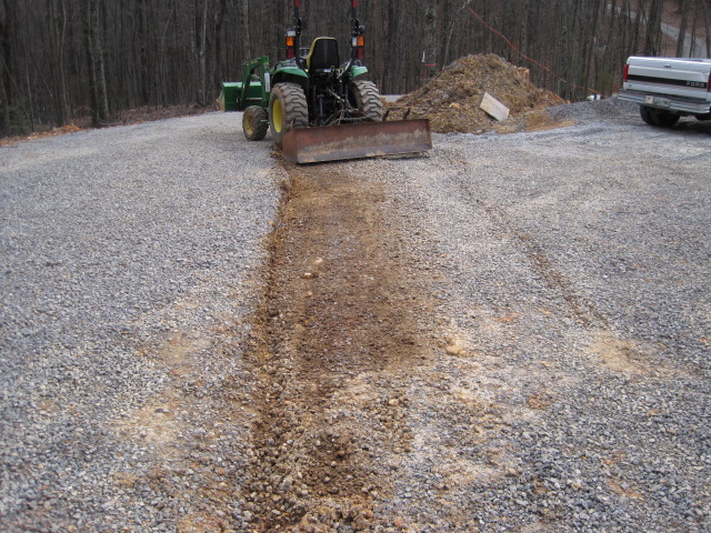

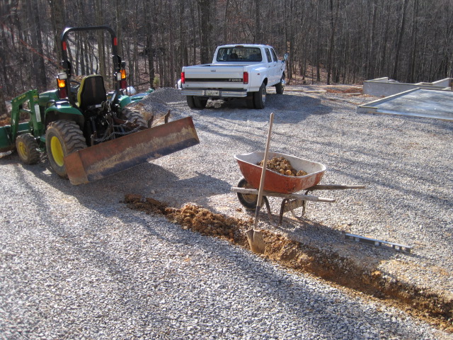

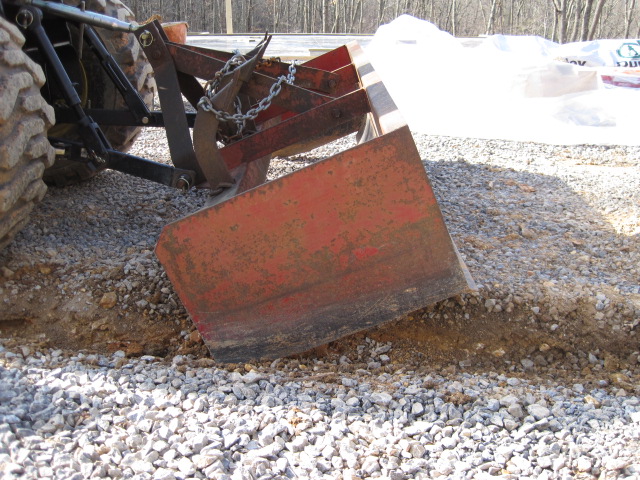

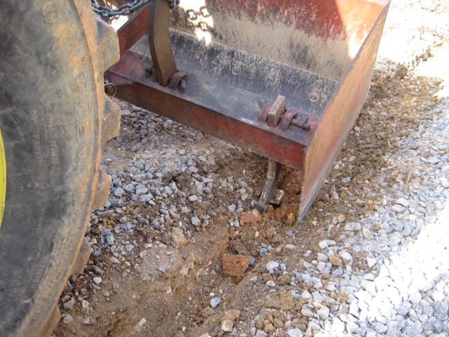

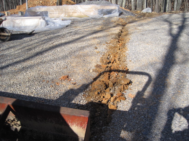

The trench I dug several days ago through the parking area has helped drain water but needed some more work. There was a high spot in the trench that prevented water from draining perfectly. I did some work on it today. I tilted my boxblade sideways and put down one shank to rip through the bottom of the trench. Unfortunately, I couldn't stay on the machine but needed to do some manual shovelling to remove the red clay that the BB shank ripped up. The temp was in the mid-20's F when I started. However, breaking out the hand shovel and maddock warmed me up quickly.
