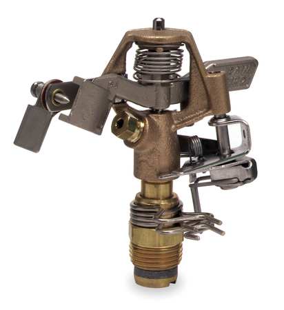

OBED you are drawing down the storage in the well a little over 1 gallon per foot if its 6"
at 17.6 gpm from the pump I think you are exceeding that flow with the sprinklers if they are the impulse ones I would set up one over a tarp on a hill and funnel it in to a 5 gallon bucket. and time it to see how much you are flowing at one time.
this rain bird link rain bird
might help to calculate flow
the key is the orifice size as to how much water is flowing
Product Description :
Impact Sprinkler, NPT 1/2 In, Material of Construction Brass, Stainless Steel Spring, Adjustable Pattern, Pressure 20 To 50 PSI, Flow Rate 3.4 To 5.0 GPM, Spacing 50 Ft, Radius of Throw 20 To 41 Ft
Professional Underground Sprinkler-Impact Head by RAIN BIRD - Irrigation and Sprinkler Timers by Zoro Tools Industrial Supplies

We are not watering the lawn, only the garden. We have 3 hose bib's around the house, one at the well, and one at the garden 200 ft from the house. We have 3 sprinklers in series in the garden hooked to the garden spigot. Watering the garden twice a day for 15 minutes does not appear to be over using the well. We have to remember to turn off the water though. We will get a timer if we can find one that will turn on for 15 minutes twice a day.
