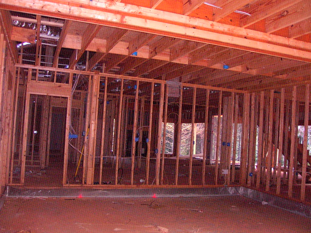

Obed - When we built our house 5 yrs. ago we used the floor joists that have plywood sandwiched between two two by fours and we have 3/4 " hardwood floors installed on to of 3/4 " Advantech sub floor and have no squeaks at all after 5 yrs..so far fingers crossed and we have no bounce to our floors all very solid. I attached a picture..they Advantech sub floor was glued and screwed.

I'm not a fan of glue. Use it when I have to but I like the old 5/8 cdx and underlayment method. Shoot it down with ring shank nails. Most of my work is in additions and remodels these days. I think the glue and screw came about by bean counters not wanting to use an underlayment. Tract houses, and spec homes, I can't argue with it.
Every time I use it, I get it on my hoses, my T square, and then if somebody doesn't break their neck when they step in it, they track it across the owner's kitchen.
Different floor finishes need different underlays. I do tile a lot and like thin-set mortar on fir underlayment for kitchens and general living areas, 1/2" notched trowel mortar bed for cementious board underlay in bathroom areas with no nails.
No squeeks with ring shanks.
