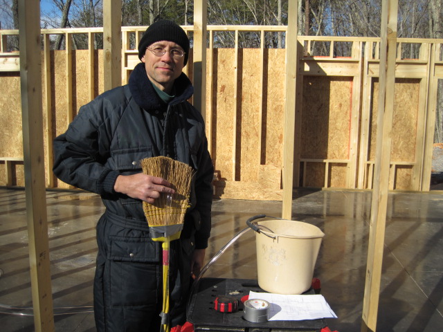

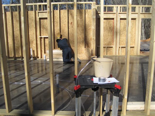

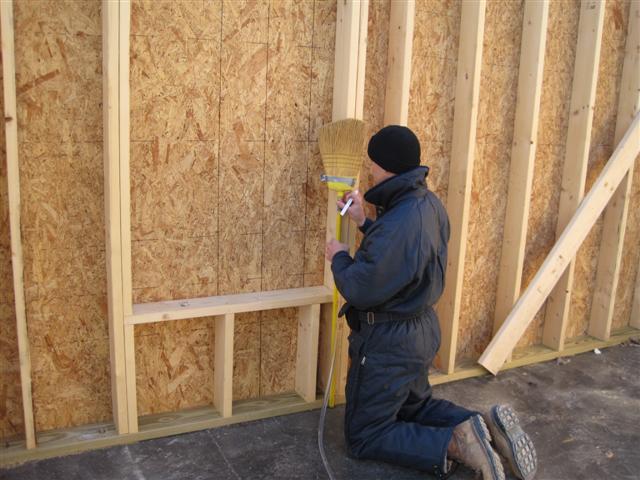

Checking the Level of the Floor
Yesterday the wife and I measured the basement walls to check level. We used a water level similar to the one described at Making and Using a Water Level . The article in the link claims a water level is more accurate than a laser level or transit. I bought 75 feet of 1/2" inside diameter clear plastic tubing at Lowes for $25.
I taped the hose to the handle of a broom to simplify the measuring. When moving from one measuring point to another I would drag the end of the broom handle along the concrete floor to keep the hose raised at almost the same level as I moved around. This technique kept the water level at the same spot in the hose so I didn't have to wait very long for the water level to equalize before taking the measurement. At each spot I marked the water level of the hose on the wall. If done correctly, every mark I made on the walls would be level with all the other marks. My wife measured the distance from each mark on the wall to the top of the wall and recorded the measurement on a house plan drawing. If you look closely at the third picture, you can see the water level in the clear plastic hose just above my left thumb.
I used 1/2" tubing instead of the 3/8" specified in the article because we would be using 75' of hose instead of 20' of hose mentioned in the article. I figured a bigger diameter hose would make it easier to get all the air bubbles out of the hose than the smaller hose. A few years ago I tried to make a water level out of a 1/8" inside dia. hose but could not get the air bubbles out of such small of a hose. The temp was in the low 20's F while we performed the measuring so I filled the bucket and water hose with warm water to prevent freezing.
We took a bunch of measurements to get an idea of how much leveling would need to be done when installing the floor trusses.

   / At Home In The Woods #445
I'm confused.
If the slab is level and the studs are all the same size, then why would you check the walls to see if they are level?
What did you find?
Eddie

I'm confused.
What did you find?
Eddie
The slab has some unlevel spots so some adjustments will need to be made.
Obed

Actually, the slab is too high in one corner and at two spots along the center load bearing wall. We need to shorten the wall at these spots by approx 1/2" to 3/4". A contractor friend of my recommended running a chalk line and using a sawzaw to cut the top of the studs just below the top plate by the needed amount. That approach seems reasonable to me.
