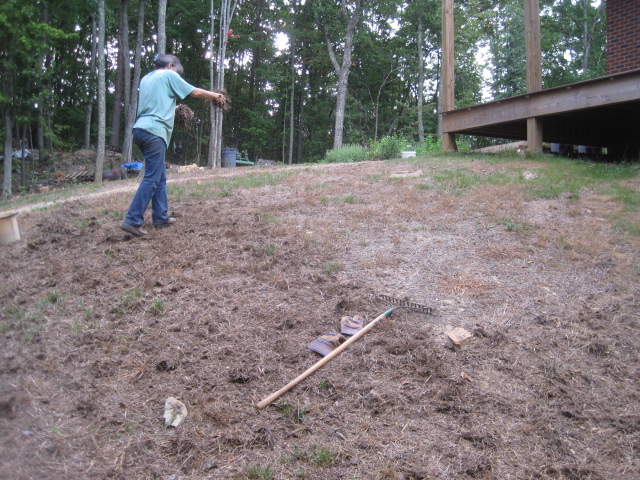

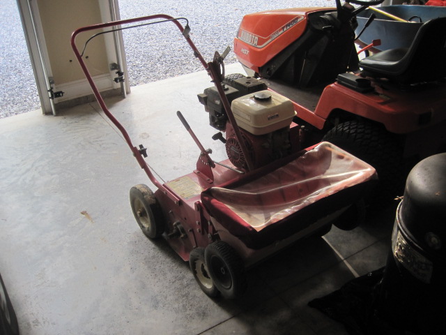

My wife sprayed Roundup on the weeds in the yard and gave the weeds time to die. Then she put down more grass seed. She rented a machine called an over-seeder. This thing has tines that tear up the soil a bit and spreads seeds in the process. She and her dad seeded 3/4 of the yard on Friday and I helped Sat morning. However, the machine would not start Sat. morning so I scratched up the dirt with a rake while my wife followed behind me and seeded.
We came to find out that we had the gas valve shut instead of open and could have used the machine. After I left the house to go play, my wife's dad came over and helped her re-seed around the garden area using the machine.

Seems like a lot of work for an area you had green grass in? But for me as long as its green i dont care what it is!! Pure grass stands take a lot of work and frequent mowing to keep up!! I do have some nice St augustine in my back yard that thankfully is so aggressive that a few mowings a summer can maintain it as it crawls and grows up to help compete. But cause i dont have irrigation it wont crawl out of the shade as it needs more moisture than is availible out of the shade.
True. The front yard wasn't in too bad of shape but had stuff in it we didn't intentionally plant. The back yard was in pretty bad condition. The grass was quite thin as a result of bad seed/straw and a very dry spring. So we try again.
