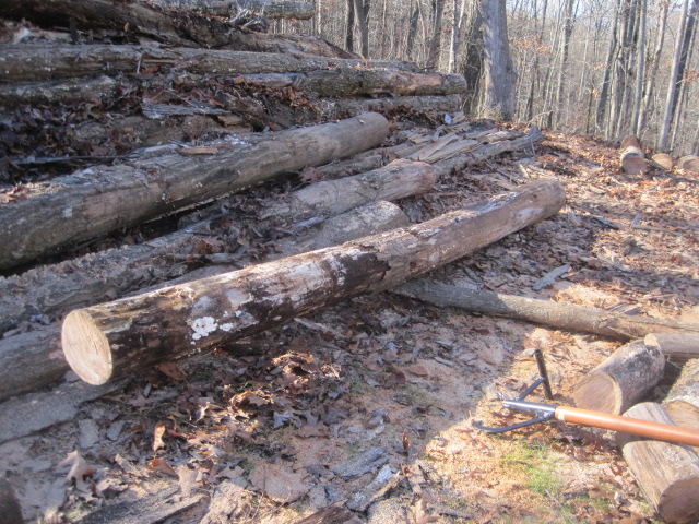

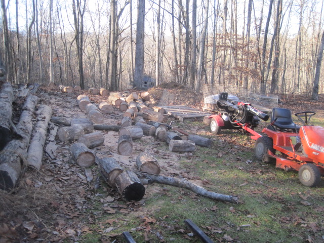

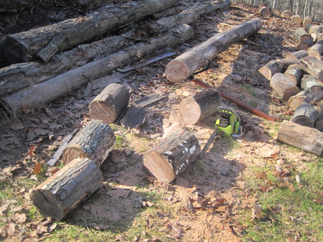

When cutting the logs on the ground, I orient myself in a full squat. I have found this position to be easiest on my back. Bending over with the chainsaw tires out my back quickly. Squatting is also good exercise for my legs.

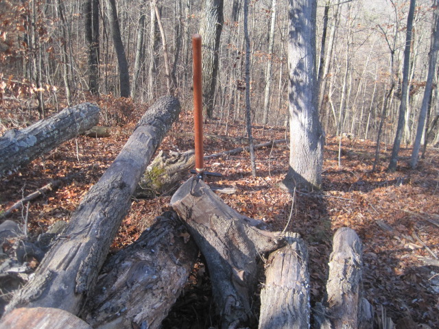

The cant hook helped me to roll a stump off the pile. Without the cant hook, I'd have had to pull the stump off with the chain and tractor.
The cant hook has an attachment that can be used to lift a log off of the ground. I am still experimenting to determine what method is more efficient. I can either cut the top of the log at each firewood section and then roll over the log and finish cutting the pieces. Or I can lift the log with the cant hook and also prop the log up on other logs/limbs to get it off of the ground and cut completely through the log.
I am ever in search of the fastest way to cut, split, stack, carry, and burn the firewood. At this stage I am sure that my process has lots of room for improvement.

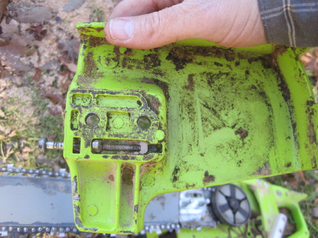

I was having trouble keeping the chain tension set correctly. I noticed the chain would somehow get to tight on the bar and cause the saw to stall. When I took off the chain cover and cleaned off all the sawdust, I noticed that there was nothing keeping the chain tensioning bolt from pulling out of it's slot. The bolt was missing a retaining ring. I limped through the last few cuts I had to make on the remaining log. Later I went to the hardware store and bought a retaining ring (e-ring) for 14 cents. Although the tensioning properties of my Poulan saw are far from great, adding the retaining ring provided a noticeable improvement.

I have a cant with a "foot". I tried propping up the log but much prefer making a bunch of cuts 3/4 through, then rolling the log to finish the cuts. The cant foot does come in handy for getting a chain under a log and that's all I use it for now.

Be careful with that timberjack/cant. They are known to let the log keep rolling or let go at an inopportune time and cause trouble. Not a problem with smaller stuff, but you can get seriously hurt on a big log that way. Generally safer if they are just supported up on something like on other logs.

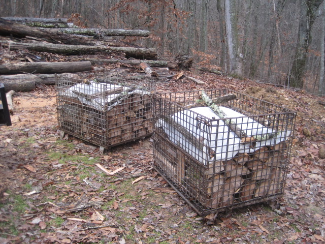

I have 11 pallets full of firewood. I had thought that that would be enough to get us through the rest of the winter. However, we have been going through the wood fast with the colder nights in the mid-20s. Also, since the wood is not seasoned like it should be, it isn't adding as much heat to the house as dry wood and requires more wood in the fireplace.

Obed;3127356I was having trouble keeping the chain tension set correctly. I noticed the chain would somehow get to tight on the bar and cause the saw to stall.[/QUOTE said:
That's strange. Even with the missing clip I would of thought your pinch bolts would of kept it in place.
Are you lifting on the bar before tightening your pinch bolts ?
Willl,
Yes I lift the bar up before tightening the bolts.

"Maybe I'll have seasoned wood to burn next year???"
All of us wood burners need to be a minimum of two years ahead on wood(no, I'm not but that's fixin to change). I guess you already know that if that creosote had managed to catch it burns at 2,000 degrees...enough to melt steel and a house fire would be a real possibility. Sweep once a month when burning green wood which is anything that has not been cut split and stacked for at least a year. Smoldering green/wet wood is really bad and makes twice the creosote, but I know sometimes we do what we gotta do.........
