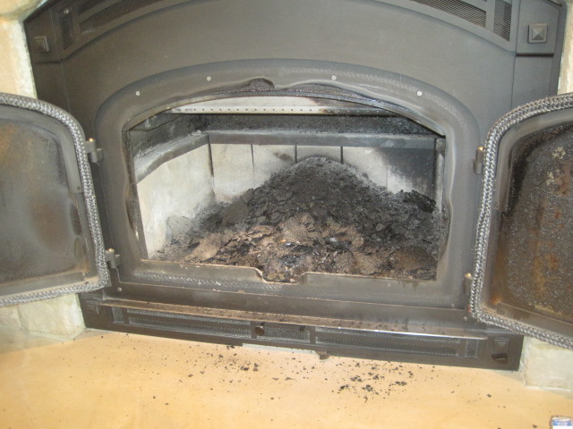

Our fireplace has a baffle at the top of it. Before I cleaned the chimney, the baffle had 2" of creosote sitting on it that had fallen down the chimney onto the baffel from regular use. We will have to keep an eye on the baffle and periodically clean it off. So the amount of creosote actually in the chimney was not as much as it would seem from the pictures.

Our fireplace is drafting nicely now. It is great to open the fireplace doors and hear the air getting sucked into the fireplace.

When we heated our house with wood, we would occassionally stoke a big fire in it, it helped a lot with keep creosote down, Of course you don't want to do that with a loaded pipe, but now that you have cleaned it running a hot flame wil help reduce that creosote load.

Obed, I don't burn wood for heat, but your photos scared the livin' poo out of me.:shocked: You've burned only one season and your chimney was an accident waiting to happen. I think you are lucky to have had some smoke back up into your house. I ran out and looked at my fireplace vent after seeing your pictures. I burn oak exclusively and most of it a very hot fire, but my chimney tiles are 13" x 18" and must take awhile to get really hot. All I ever see is thin black soot coating. Do you think you may have clogged that chimney due to your original problems with your insert? I'm thinking of an insert so I can get some benefit from all the available firewood on my place. Those photos of yours sure will make me take the installation seriously. I'm going to put an insulted stainless duct up my flue even if it is only 10 years old. Thanks for posting that sobering evidence that installation, dry wood, and burning technique are so important.

You have a tall chimney. It makes sense that the creosote is condensing out at the top when it reaches cooler outside air and has cooled some already since leaving the fire. I think burning better cured wood (2 yr min. for oak) and burning with a hotter flame will help. Sometimes it is better to burn smaller split pieces with a bright flame than big pieces--which if burned hot would overheat your insert.
Someday ... check the temperature of your chimney cap while burning, I bet it isn't very warm.
