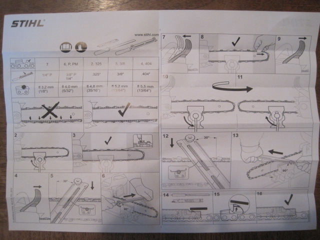

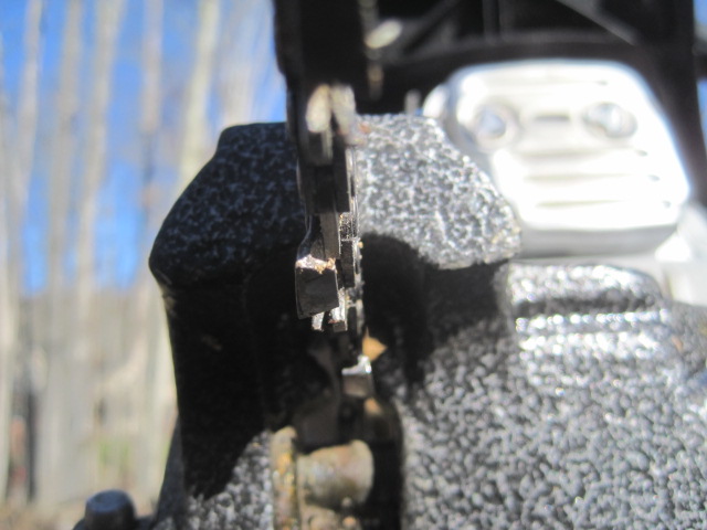

After I filled up the trailer with bucked wood and the saw ran out of gas, I tried my hand for the first time at sharpening a chain. I clamped a portable vice to the trailer railing then clamped the bar of the chain in the vice. Unfortunately, the vice has a protrusion that interfered with the chain so I couldn't use the vice.
So I placed the saw on some wood in the trailer and held the saw in place by resting my chest on top of the saw. I filed each cutter two strokes. Sharpening didn't seem that difficult to do after I watched a few videos. I did not find the instructions that came in the Stihl sharpening kit extremely helpful (all pictures, no words) until I watched some videos. Then the picture book instructions made more sense.
I then removed the bar and cleaned the saw and bar according to the chainsaw manual.
Now that I have a new saw, I want to take care of it. I definitely want a sharp chain. For now I may hand sharpen the chains and take them to the store periodically for a professional sharpening.
   / At Home In The Woods #4,654
It's hard to tell in the pics, but I don't think you filed that cutter correctly. Only use the round file on a cutter and it goes in the gullet, not on top of the cutting tooth. The flat file is for rakers and is not needed until about 40% of the cutter is filed down.

#4,655
Rick,
I'm not sure which picture gave you that impression. I filed the bottom edge of the cutters with a 13/64" round file and a Stihl file guide just like the videos. I did not use the flat file and I did not file the rakers.

   / At Home In The Woods #4,656
Ok, it is that third pic on the right, top row. My bad then......Charlie Mike(Continue Mission):laughing:
Rick I think that picture is just to show how the vice had bump that would not allow him to use it. What we are looking at is the back side of the teeth on the bottom of the bar going toward the engine. It took me awhile to figure it out.

If you clamp the bar farther away from the saw, it is better for stability and the chain might clear those bumps better. You have the right idea, just need to get a different vise or grind off those bumps for better clearance.
I made myself a vise from wood that use in my shop bench. I use a bar clamp to hold it in, but the jaws are wood to avoid damaging the chain or bar. You could add some thicker wood jaws in place of the metal ones to give you more space and protect the saw better.
