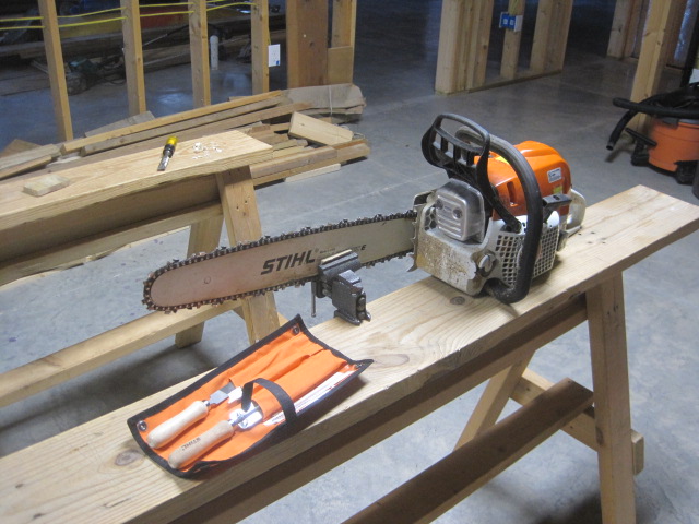

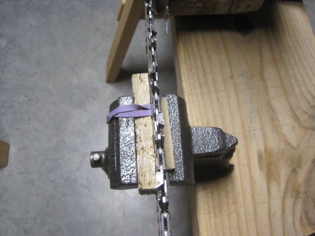

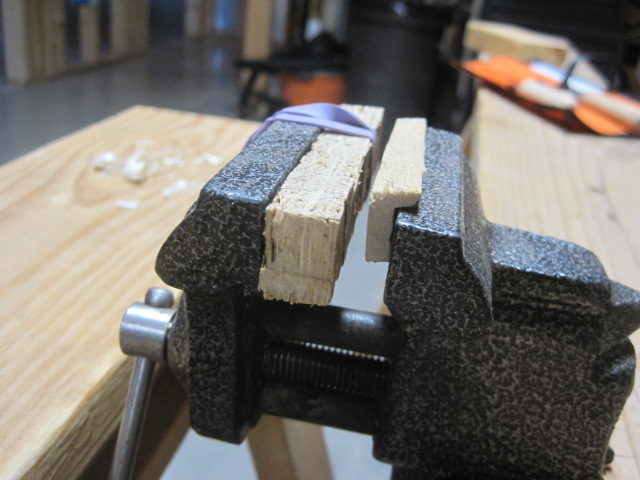

I sharpened my chainsaw on a saw-horse in the basement.
I jury rigged a couple of pieces of wood to place in the portable vice so the protrusion jutting out of the vice would not interfere with the chain. The chain got in fairly bad sharpening shape the last time I used it. I was curious how well hand sharpening would work. I took 4 strokes with the file on each cutter. Afterwards, the chain performed nicely.
