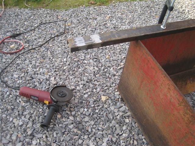

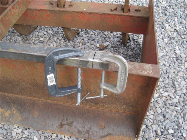

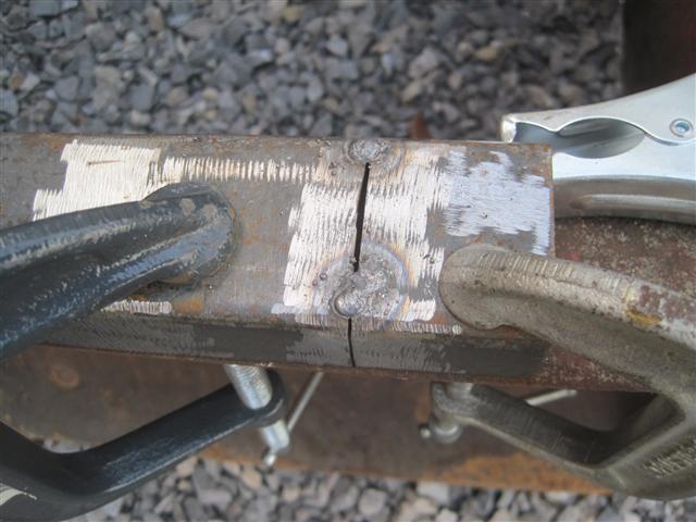

Tonight I made my first attempt at welding something together. I cleaned off some of my scrap, then cut a piece off of the end.
I made a couple tack welds to help keep the pieces together while welding, then laid a bead along the top.

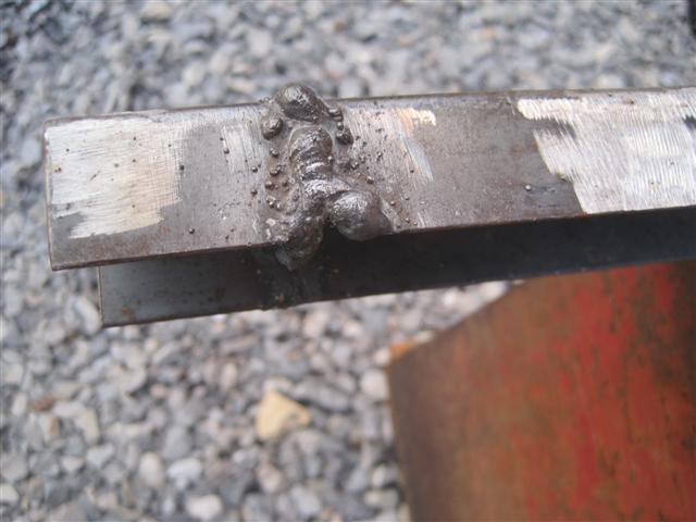

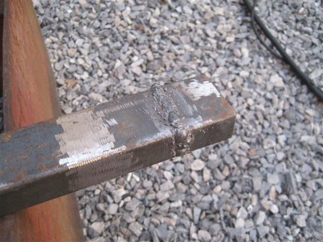

I reoriented the metal and welded the first side. It came out fairly ugly. I'm having a little difficult starting a weld where I ended the previous weld. By the time I have heated the metal enough to get a puddle, I have a large glob of weld resulting from feeding the wire while I'm waiting for the metal to get hot.
The last side came out even uglier. At the end, I melted away my metal leaving a large gap at the bottom.
I used the grinder to cut off the excess and then tried to fill in the gap by adding more welding wire. That didn't turn out too great either.
Here's what the final result looked like. I got out a hammer and banged all over the newly welded on piece and it held together. I guess that's what counts even if it's not real pretty.
I think I should have left a slightly bigger gap between the pieces before I welded them to let a little more weld penetrate a little deeper. However, I'm reasonably satisfied with the result for my first real weld.

I think your welding is off to a good start. I have never used a wire welder, so I am not much help in analyzing the welds. It's definitely one of those "practice makes perfect" skills. Strong is good, strong and pretty takes practice.
   / At Home In The Woods #4,997
Obed, looks like a good start for self taught, beginning welding. Can you operate a nuclear power plant on those welds, no. Could you count on them to hold a draw pin on an implement? Absolutely! That's the first goal, getting welds of sufficient strength to do what you intend (holes and all). Then or worry about "pretty." Eventually pretty welds will have the needed strength with practice. Once you can strike an arc consistently, you can begin to experiment with wire speed and amperage.
How thick was the base metal, and what setting did you have the welder set to?
The metal doesn't look that thick, and when you are learning thinner metal can be a bit of a challenge.
You should have a puddle of molten metal VERY soon after striking an arc.
It may be obvious, it may not... you burn though when you leave the torch in one place too long. That end of the piece weld goes faster than the in the middle of the weld.
You can do that... you've burned a "U" in the end of the weld. Trace around the inside of the U once, and then stop. Let it cool. Clean the slag. Now you should have a smaller U. Trace around the inside of the U, cool, clean, repeat. Eventually the U closes up.
The downside to a flux-core welder, is you MUST clean your old weld before putting new weld over, or near the old weld. If you don't you'll get slag in the weld , and that will create a weak spot.
What you do for deeper penetration on thick material is bevel the edges at a 45 degree. Then you weld straight down the middle. Then clean, and lay another pass on top. This time you weave a bit from side to side to make a wider weld. Repeat until full thickness welding has occurred.
If you have a very wide bevel, you might have to do 2 or more passes one on each side to fully cover the gap, but that is probably not something you are likely to get into with this welder.
My other suggestion is to practice laying good looking welds on a thick (so you don't burn through) flat plate. This will let you work out your hand motion, travel speed, machine settings etc... and get a good looking bead of weld. Once you can get a good bead, repeatably, then you can move to a work piece, and put that good bead where it needs to be.
Looking at your welds they are 'tall' i.e. standing up off the base metal. This is usually due to too fast of a wire speed. But it looks like on your machine you only have 1 control. Most mig machines have 1 for wire speed and 1 for voltage. So I'm not sure what to tell you to adjust as I've not worked with this kind of machine.
jdonovan, thanks for the tips. They are very informative. My practice piece is pretty thin; it's 1/16" thick. The welder was set to low current and wire speed 3.5 out of a possible 10.
I think that's the part I didn't realize - that the end of the piece weld goes faster than the middle. That seems to be what I observerd.
I guess that takes some practice. I probably should have waited until I was done filling before removing the excess with the grinder.
Yes, that seems to slow things down considerably. It makes you not want to stop your weld bead once you start it.
I should get some thicker stuff on which to practice, especially since my box blade parts use thick metal.
. The tallness of the bead along the middle/top of the piece was about what I wanted. It could have been a little less tall. I had more trouble along the sides where I was trying to get the weld "started", i.e. hot enough for a puddle to form where the previous bead ended. The previous bead was already tall enough so when I started the new bead where the previous bead ended, I ended up with too much material. I think that I was also going too slow which allowed the weld material to build up too much.
Exactly. This is one of the major down sides to any flux shielded process... including stick welding. But my flux doesn't blow away when I weld outside like my gas-shielded mig/tig does.
To slow should have lead to too much heat in one spot, and a flatter, wider weld profile. If the bead is tall/narrow it usually means a cold weld, with too much wire feed.
