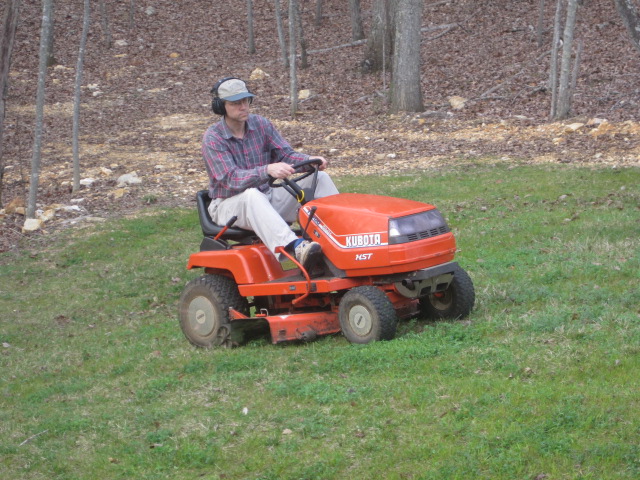

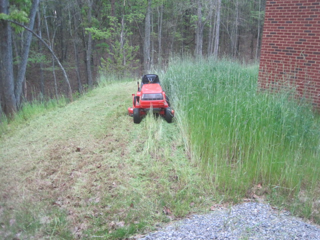

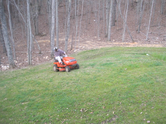

I mowed the yard for the first time this season. The mower performed extremely well with the new belt and tension spring.
It's nice to not get behind on mowing the yard like I did last year when my mower didn't work at the beginning of the season. Here's what the first mowing looked like last year.
