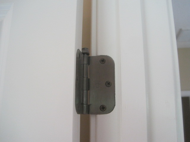

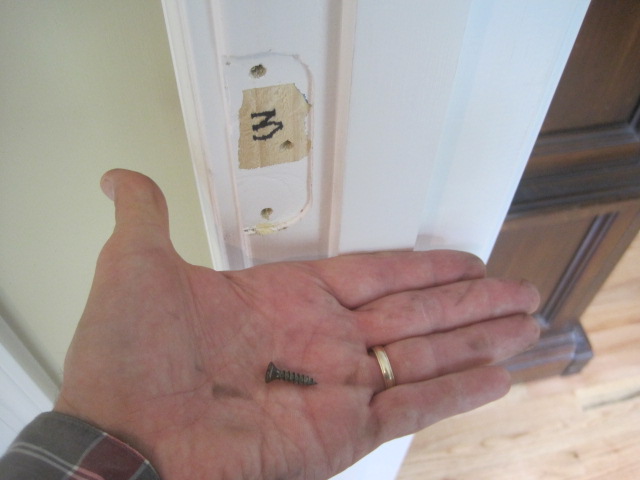

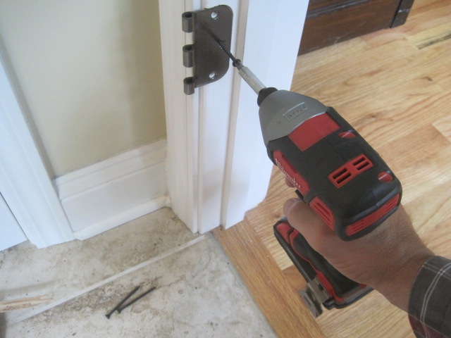

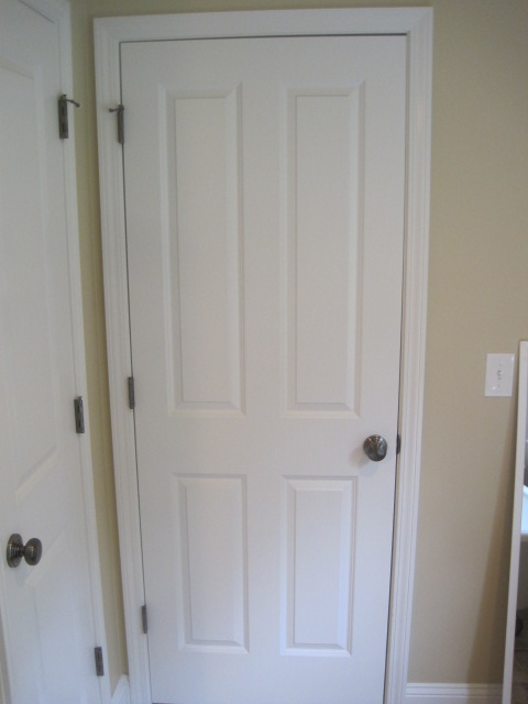

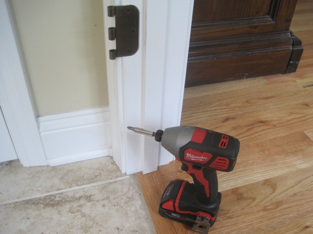

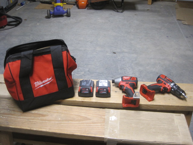

We bought a cordless Milwaukee drill and impact driver. I used the impact driver to fix a door hinge problem.
The door to the master bath is a heavy 32" solid core door. It was installed using tiny screws that only secured the hinges to the soft 3/4" door frame. These short screws could not hold the weight of the door so the door sagged. You had to lift the doorknob in order to close the door.

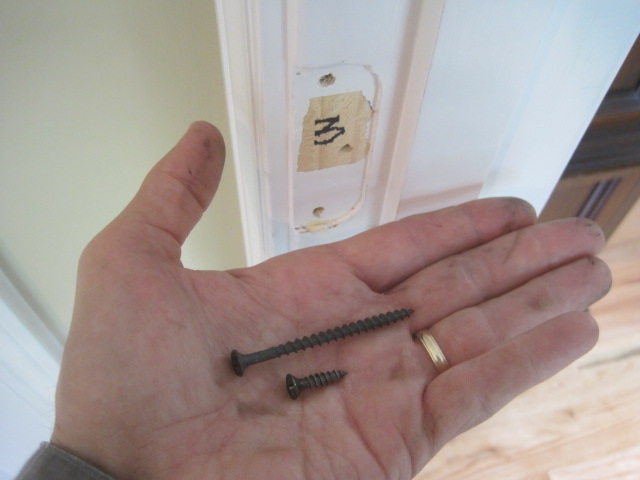

I replaced the 3 short screws in each hinge with 2 1/2" long screws. These screws were long enough to secure the door hinges to the studs in the wall. Using the impact driver to drive the long screws into the studs was wonderful. There was no issue with stripping the phillips screw heads. When the resistance of the screws became great enough as they went deeper, the impact driver automatically switched from screw driver mode to impact driver mode. It makes me never to want to use a drill again for screwing screws.

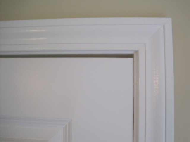

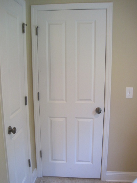

Here's the door after installing the long screws. You can see it is no longer sagging. The door closes smoothly now.

2X on that- I was hanging a ledger board on our banrs studs for a shelf running all 45' front to back at 8' up, and using a socket and rachet to drive the lag screws in, and after just a couple my arms and hands started to protest (a combo platter of carpal tunnel, tennis elbow, and nerve damage from a blown disk I had to have pulled out of my neck), just then I remembered that I have an impact wrench and using that they screwed in slick as poo from a goose and with only the work of holding on and pulling the trigger.
Since then, I also just bought an air-powered socket wrench on clearance from TSC, but I haven't had an occasion to try it out yet.
